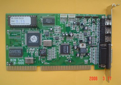

Here is a picture of an Ikon IK-1000 which has the same chipset as the Reveal card, though such a large BIOS is a rare sight on a soundcard. As far as sound and configuration are concerned, it should be exactly the same as the Reveal card.

There are also similar cards but with a newer Crystal CS4236 or CS4237 instead of the CS4232. These newer chips have integrated FM circuitry branded 'Crystal FM' and will therefor no longer use the CS9233 for FM, or any OPL3 chip for that matter.
The only cards I know of that have the CS4232 paired with a Yamaha OPL3 are the Acer Magic S23 and the Turtle Beach Tropez Plus.

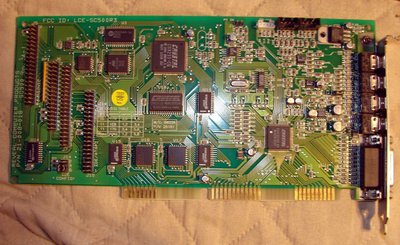

Well, I'm still keeping an eye out for a genuine SC500 Rev. 3, or functionally-suitable alternative that isn't a victim of eBayflation. In the meantime, I finally did manage to find a large picture of an SC500, it sold on eBay back in March as part of a lot with a 486 motherboard. I only managed by pure luck to find this by searching Google for the part number (21-008-018).
364.59 KiB
1650 views
If by random chance anyone happens to have one of these cards and perhaps just doesn't know it off-hand, the staggered positioning of the four CD-ROM interface connectors should make it visually stand out.
