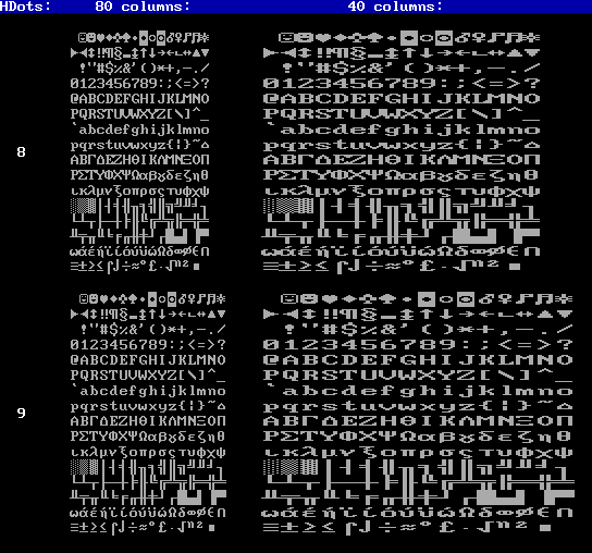

^ thanks for the offer appreciate it!
but since then I bought an "official Greek" 5155 portable that came with Greek keyboard and character rom:
Memotek was IBM's distributor at the time. The rom is here if you want it: http://www.mediafire.com/file/k97l119xsnv0cf5 … tek-gr.rar/file , IIRC it has a couple of banks with different charsets.

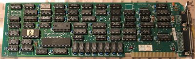

Reply 21 of 38, by Predator99
Just had this one in my hands. Think its the same MDA Keropi posted above, but different ROM.

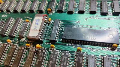

Hi,
My IBM 5155 has an original MDA/LPT1 card and a original CGA card. Both of them has a ROM mod. Pin 21 is removed from the socket, and connected directly on to pin 24.
Maybe this is a necessary mod when using MDA and CGA at the same time?
I removed the MDA card, and the CGA still works fine with the mod.
PS! The BIOS on the picture has Norwegian characters. I swapped it with the ROM in the MDA card witch has English characters. The markings says "farve" with means color. To be clear the ROM removed from the MDA and used in the CGA has the same modification on pin 21/24.

The original Monochrome Display and Printer Adapter and the original Color Graphics Adapter work perfectly side-by-side without any mod. Your picture shows that an EPROM is in the character ROM socket. The shape of the case and the fact that it is a ceramic case are dead giveaways that this ROM is not the factory-provided mask-programmed ROM. The bodge wire connecting pin 24 (VCC) to pin 21 (likely an address pin or Vpp) is very likely needed to make standard EPROMs work in that socket.
