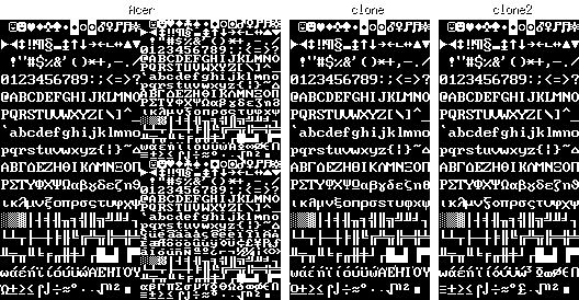

Anyway, thanks for those dumps! Here are the bitmaps-
8.68 KiB
2050 views
A bit odd that those MDA clones don't have IBM-style 8K ROMS and with the 8x8 fonts included... but I guess that part was simply stripped out since it's never used on MDA anyway.
BTW, I think you should be able to burn a Greek ROM for your IBM CGA using the Acer one as a base? unless you want a 'thin' font as well?

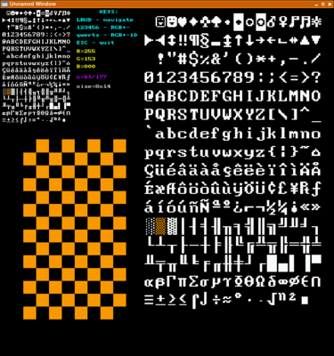

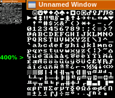

How did you extract the fonts from a ROM dump? And how did you create these images?
I recently have dumped a Commodore 386SX-25 with an onboard AVGA2/Cirrus GD5402. I have the ROM-dump and now I want to find the start of the charset(s) in there, without using the 386 (INT10).
Reply 14 of 35, by stecdose
I started disassembling the ROM with IDA Pro. I already found the 8x8, the 8x16 is next.
Two ways to find the charset:
1) First three bytes of the image are signature+size of ROM. Directly after this comes a JMP to the init routine.
In that init routine interrupts 0x43 and 0x1F are set up. 43 holds the address of the lower half of the charset. 1F holds the address of upper half. Each half is 1k. Cut this from the ROM.
2) search for 8 zero bytes in a row. check if the next 8 bytes would draw a smilie (8 zeroes = all blank = ASCII 0x00, smilie = ASCII 0x01). This is the start of lower half. Upper half immediately follows (at least in my ROM).
Way 2 I am going now for the 8x16, just searching for 16 zero bytes in a row. I already found, but still not sure by +-2bytes. Need to try or count in disassembly.
Attached the bin-font, a generated header for C and a test program in C that uses SDL to draw the charset. Also a screenshot. And a program to convert the bin file to header.

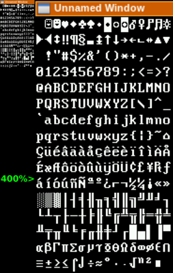

And finally I found the 8x16 😀

Here is another one, a very nice looking 8x14 from a NCR GD5428.
