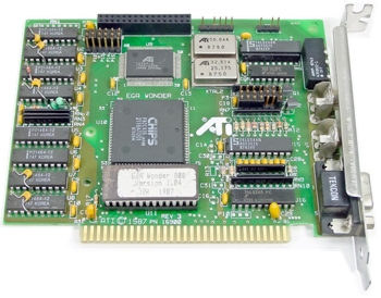

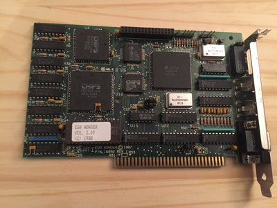

the video card is ISA and says EGA WONDER ver 3.09 (1988)
www.minuszerodegrees.net/manuals/EGA%20 ... 01988).pdf
and seems to have RCA outputs of somekind? + a 9 pin EGA output
i couldnt see a brand name on the io controller
im wondering what i can do to increase its performance.. should i get a different ISA video card?

Yes, sounds like a good plan. A VGA card will give you better compatibility with software, more colours, higher resolutions etc (also nicer for Windows). I'm surprised there's an EGA card in there in the first place. That's probably not the card it was sold with. By 1990, VGA was already standard for every new PC.
When you get a VGA card, make sure it's a fast one. ET4000 if you can, or a Cirrus Logic one, perhaps Paradise. Stay away from Trident, Oak, Realtek and the like. They will bottleneck the 386DX-40 a lot in games.
I would hold on to that EGA card though, because EGA is a lot more rare than VGA is. Or if you don't want it, then I'm interested 😀

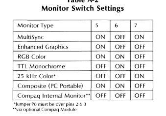

Reply 2 of 60, by chrisNova777
Interesting
the card has dipswitches accesible frm the back pci bracket area to switch its video output
for different types of monitors

Reply 4 of 60, by chrisNova777
im guessing "multisync" is the best of those monitor types?
Reply 5 of 60, by Caluser2000
Only if you have a suitable monitor. If you insist on getting a EGA to VGA converter I'd imagine Enhanced Graphics is the one to select. You can avoid any dought and extra complexity(converting the video from digital to analogue output) by just getting a suitable VGA card as Scali suggested. Funny thing is though that the converter might be the cheaper of the two options looking at the current e-bay pricings.

the graphic card in it is an EGA wonder
Release Date: 1987 […]
Release Date: 1987
ATi EGA Wonder (March 1987)
Chipset: ATI16899-0 + CHIPS P86C435
Supports CGA, Hercules mono & EGA graphics modes
Removes support for plantronics mode/Single-page Hercules mode/composite output
Compatible with MDA, CGA and EGA displays (DIP switch selectable)
Internal composite port for machines such as IBM 5155 Portable
256kb DRAM
Port: 8-bit PC/XT bus
Original MSRP: $399
ATi EGA Wonder 800
Added support for extended EGA text and graphics modes (requires multisync monitor)
Added support for 16-colour VGA modes
ATi EGA Wonder 800+
Rebadged VGA Edge lacking the analogue VGA port
Chipset: ATI 18800
Can auto-detect monitor type connected (DIP switches no longer present)
not sure if its an 800 or 800+ but the sticker on the chip on the card says "EGA WONDER ver 3.09 (1988) "
is there any chance the RCA outputs is a video composite signal?

Here is a real pic
