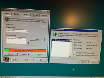

I have a CT3900 AWE32. It has the 4.13 DSP but also the CT1747 bus interface, so there *should* be no illegitimate hanging notes.
I have a 4MB Dream synth DB on the card, but I also have 32MB of RAM that I use for loading a 25MB sound font.
I'm not exactly sure how to select between these two options for GM when I launch DOS games from a Windows DOS box.
Do the tick boxes in the Device Selection (see pic below) have anything to do with it? Thanks in advance for any help!

Thanks guys. I believe that checking the box uses the soundfont and unchecking the box uses the DB. I tested it with the Tyrian setup, which is a nice way to check all three banks, including the EMU8K.
I was having the hardest time understanding what "Allow MPU401 Emulation on this device" meant for the synths. Still not intuitive to me, I'm afraid.
