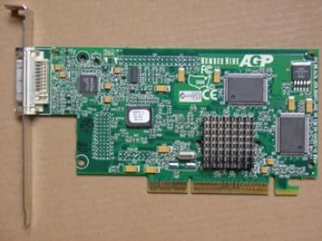

Hey guys, before I pour tons of hours into researching this, does anyone remember if there was ever a DVI graphics card with Windows 3.1x drivers? Or did DVI come too late?
Basically the desk in my tiny new apartment can't fit two sets of peripherals 😢 , so looking to build a KVM setup. If I could get a DVI card for this old Pentium 3.1x/95 tower, I could have it on the same unit as all my other machines.
I learned the hard way DVI KVMs universally use DVI-D, so passive DVI to VGA passthrough adaptors won't work. It's a real shame, I have the keyboard and mouse working with a ton of adaptors.

S3 Savage4
61026w31.zip 560k 2000 Jul 24 S3 Windows 3.1 display driver v.6.10.26 6/13/00 for Savage4 (DeviceID 8A22)
NB! AGP card! Must it be PCI?
Reply 5 of 12, by vetz
TNT2 is also an option. Came primarily with AGP DVI, but it has the drivers.
PCI option also available, but hard to find:
GB Riva TnT Pro (Gateway Wallace AGP DVI-Out) CT5828

Reply 9 of 12, by NJRoadfan
Most Matrox G400 cards support a DVI output daughter card. They have full Windows 3.1x drivers with on the fly resolution switching. I can confirm the DVI output works with the drivers as well.

Reply 11 of 12, by NJRoadfan
