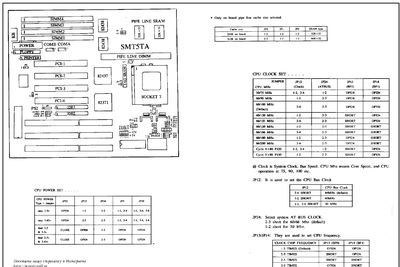

Hey guys! I just get this old Socket 7 motherboard from the auction website, but I can't find any manual or jumper instructions on the web 😵
I have no idea how to set it up in the right way, so if anyone ever seen or used this board before, please teach me how to let it work, thanks!
Photos Here : http://imgur.com/a/0BjmW
Board Model : SMT5TA-2.3 (Manufacturer maybe is SMT or NewTech?)

bbhaag wrote:
Is this the right board? The layout looks very similar to your pictures.
Yes! This is SMT5TA jumper manual 😲
Although the JP numbers are not completely match, but it's really helpful 😀
Just a moment ago, I follow the jumper settings (CPU 3.45V) on the manual and connected the power supply to test this board, but when I turn on the power, nothing shows on the screen 😵
I am sure that CPU/Chipsets and SRAM will be warm when the power is on... I don't know why the screen and speaker have nothing output.
If you guys have any idea, please tell me, Thanks!
*The Graphics Card is S3 Trio64V2/DX
*I have tried different jumper settings but nothing happened...
