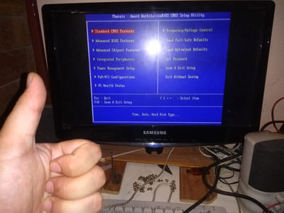

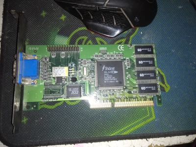

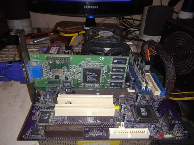

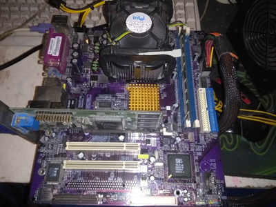

Greetings! Today I tested a model that is not on the list, it is an ECS 651-M v1.0, Under the heatsink it has a SIS 650GX chipset, it works perfectly with the Trident Blade 3D 9880 AGP. Soon I will be using it with a pentium 4 1.5ghz Willamette (s478), an Aureal Vortex 2 and a Voodoo 3! (when arrive)

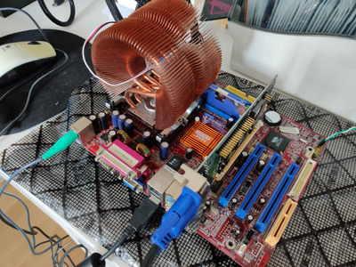

I can confirm that Biostar U8668-D is supporting 3.3V cards. I just tested with an ATI Rage Pro Turbo, and it worked fine.
