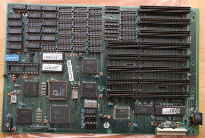

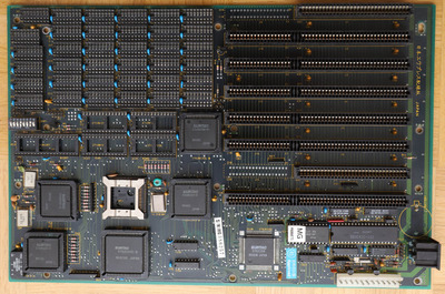

...also some new Boards:
The attachment IMG_8283r.jpg is no longer available
The attachment IMG_8285r.jpg is no longer available
The attachment IMG_8282r.jpg is no longer available

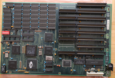

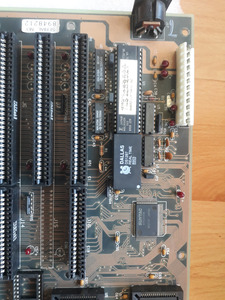

Reply 181 of 224, by HiroSK

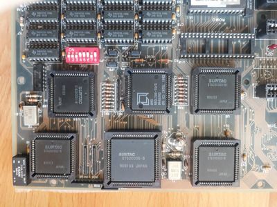

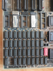

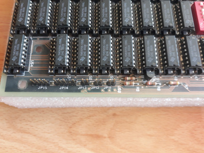

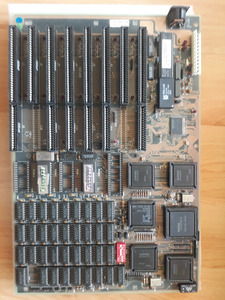

Hello, can't find any info about this board... Any idea about jumpers? For example where is turbo connector? External battery?
Suntac V2.06 (or V2.08) (wrote on board) Protek (wrote on board) BIOS 3.03HL "LOGO STAR" (shown under BIOS version line) AMD N80L286-10/S 1MB memory DIP switch (looks the same as on other Suntac boards)
ST62C005-B ST62BC00I-B ? ST62BC001-B ? ST62BC002-B ST62BC004-BI ST62BC003-B
Reply 182 of 224, by dorkbert
This looks like the board I had. Mine also did not came with docs. If I recall correctly, it uses the same dip switch settings as other suntac boards.
