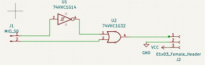

I've got a small update from my side-by-side interposer. As I didn't get the cache working, I wanted to hook up MEMW in order to be able to use cache flush. Normally, this is one of the pins of the ISA bus, however I have an IBM with only microchannel slots, and MCA doesn't have a MEMW pin.

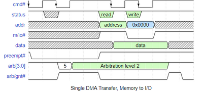

After digging through the MCA specifications I found that two pins are used to the same effect: S0 (pin A32 on the MCA bus) is WRITE, and MIO (pin A34) toggles between memory and I/O. The combination of this would be equivalent to MEMW.
The attachment SingleDMA.png is no longer available
MEMW is active low, so I needed a circuit that did: MIO high + S0 low = low
For this I used a NAND inverter for MIO and feed the inverted signal and S0 into an OR gate, and hook the output to MEMW.

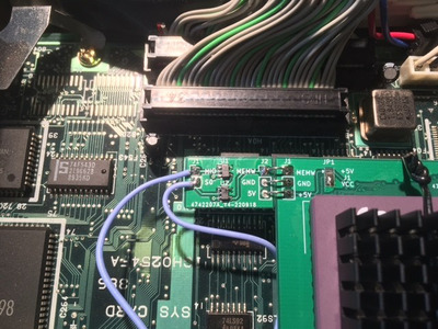

I made a little pcb and tacked it to the interposer:
The attachment IMG_4029.JPG is no longer available

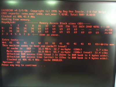

With [CYRIX.EXE -f -m -cd -xA000,64] the system now reports a working cache:
The attachment IMG_4027.JPG is no longer available
The cache works in practice, I went from 9700 RTs in doom with the original 386DX-20 to 3100 RTs with this contraption, a three fold improvement. Unfortunately it is not rock solid; doom works fine, but command&conquer locks the computer during startup - UNLESS i run doom first, and then c&c :'-D and then it still crashes after half an hour.
I tried everything I could imagine (A20, first 64k, BARB, excluding different zones) but so far nothing had any effect on this behavior. I find it very mystifying; does doom leave something behind in memory?

Nice bit of detective work for finding a MEMW alternative on MCA.
That DOOM score of 3100 realtics is too good for an SXL2 at 40 MHz. Are you running it in full screen?

I'm running the low detail benchmark haha 😀 I guess if I want to really play doom, I'll go with fdoom.

Oh wow, very nice :p
Hope you figure out why there are instabilities. Maybe a non related problem is rearing its head? Or maybe a timing issue? Are there faster components you can try?
Btw, I may have enough room for that on the back side of the interposer.
Can you upload the kicad file? I can try to copy it to the interposer.
That's pretty cool, but do keep in mind almost nobody is going to use this option, so make sure its optional and people do not need to components to use a normal MEMW signal.
In any care, here you go:
