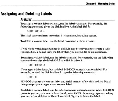

I have installed Dos 6.21 with Ontrack Disk Manager to get 4 x 2GB partitions but when everything was made it used default names for the root or volume names is there a dos command to rename these or do I have to reformat them and name them after?

Normally you just go to the drive and use the command "label".
