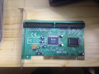

I recently acquired a PCI ATAPI/RAID controller that is not playing ball with my system. It is currently running an older version of the RAID BIOS, but I believe there are several newer RAID BIOSes and some ATAPI BIOSes (which I actually need because I don't want RAID, but a controller that will run all my HDDs and opticals in ATAPI mode). My plan is to find generic BIOS files for PCI controllers and flash using uniflash..
Unfortunately, ITE's website no longer hosts these. Does anyone know where to find them?

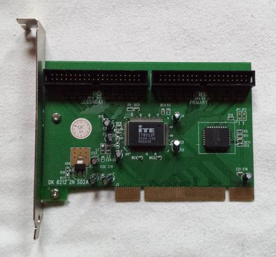

Because I saw this thread, I bought an ITE8212F (IT8212) PCI ATA-133 Controller, because my new motherboard do not offer any PATA connector anymore.
It was a Lindy 51112 PCI Ultra ATA-133 Controller, which offers RAID functionality also.

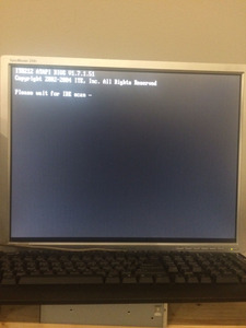

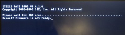

Unfortunately this controller does not recognize any removable media drive (ZIP, LS-120) but mainly a LS-120 was the reason I need also PATA.
At boot time, it scans for any IDE device, but the LS-120 (which works properly in an older AM2+ PC) isn't detected.
I guess this is related with a different handling of hard disk drives vs. removable media drives.

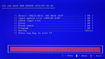

So I thought it would be a good idea to flash the controller's BIOS now (with the INT13H.BIN image from this thread).
But at the end of the flash procedure, verify fails. The original BIOS of the controller is still there, unchanged.

    Scanning IDE bus not found nothing (there is a working LS-120 drive connected).

Reply 6 of 12, by Tiido
!WE line of the flash chip needs to be isolated and connected to the required pin on the controller, only then will the updates to its BIOS be possible.
Reply 7 of 12, by Peter z80.eu

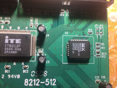

What does that mean ? Isolated means desoldering ? Plug in a Eprom burner (which is able to program flash chips) ? Sounds difficult and it means too much effort (card will be thrown into trash can, as already said).
And there is no "!WE line", the chip is a Holtek HT27C512-70B, which sounds like an one-time programmable EPROM (because there is no small window to erase it with UV light).
Also, I was even not able to *read* out the ROM content with UNIFLASH (contained only zeros).
Reply 8 of 12, by Tiido
Cutting a trace to the pin if it is tied to VCC and soldering it to the !WE line from the controller (one of the IDE2 pins) if it already isn't there. But anyway 27C512 is indeed an OTP EPROM so no upgrading that without swapping chips.

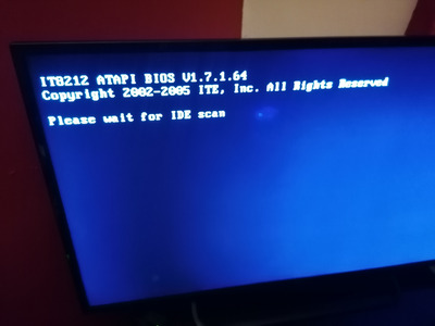

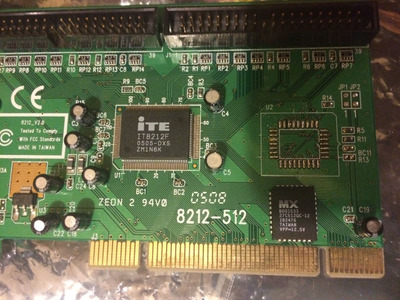

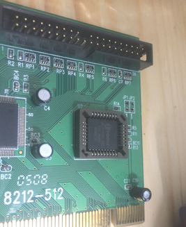

I found a bunch of these controllers in an old company warehouse and decided to add one to my vintage computer (which has an 8 gigabyte limit). Unfortunately, all of these controllers had an ancient RAID BIOS in a OTP ROM soldered on the board. I decided to replace them with FLASH and fresh ATAPI BIOS. Luckily I read the spec sheet on the 39f010 and 27c512 before doing it. They have different pins. After some googling I found a Winbond 27c512 chip which is electrically erasable and I flashed bios_8212ATAPI-093015-02 with my TL866.

Reply 11 of 12, by Roman555
alec_v wrote on 2022-11-26, 23:25:
Is it really MX 27C512QC is OTP ? I see on the photo "vpp=12.5v" on it.
P.S. Looked up in the datasheet - yes, it is
