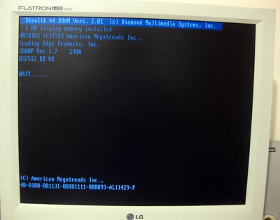

I have one of these boards with version 298A BIOS, however, I see one of these motherboards on eBay with version 299 BIOS. Anyone have BIOS version 299 or later from a Daewoo AL486V-D and can share the image?
Stickers with 295 on them have BIOS identification string: 26XYR version 1.4
Stickers with 298A on them have BIOS identification string: 2600P version 1.7
299?

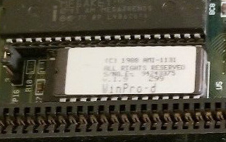

Nobody have this BIOS? Apparently "299" is version 1.9. Attached is an image I found online.

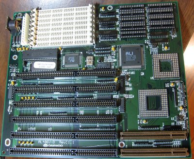

Reply 9 of 22, by feipoa
Yes, AMI-based. String here:
252.08 KiB
479 views
