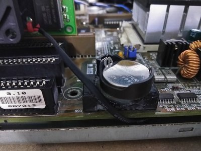

Reply 17 of 27, by Briggz
I know replacing the RTC with new replacement would look neat and tidy but in my opinion its going to go flat again in the future and that means busting out the soldering iron and replacing it again.
I did the cut and grind on my board which wasn't too hard, I don't have a dremel but I did find a small cheap grinding attachment from the hardware store that goes in any cordless drill. It was a slow process but it did the job, I was able to pull the original battery out then solder a new battery holder in place.
It worked out especially handy one time when my computer wouldn't boot/post just blank screen, in a last ditch effort to get it working again I pulled the battery out to reset the bios then put it back in and voila! the computer worked again.
    172.77 KiB
    2577 views
Reply 18 of 27, by root42
Wow. This looks... interesting. Remind me never to buy a board with a Dallas RTC...
