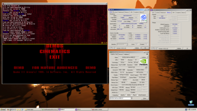

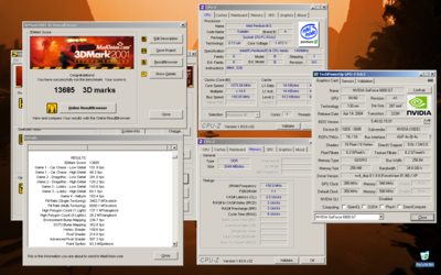

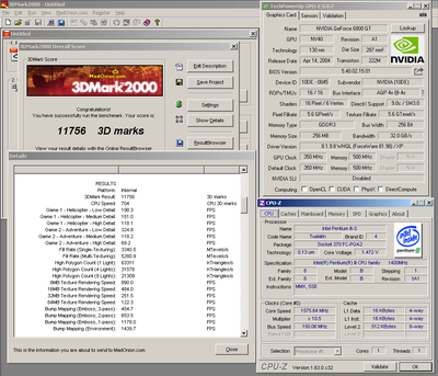

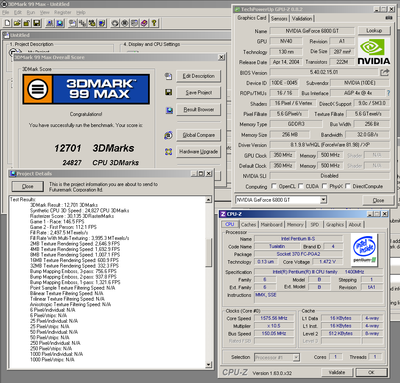

Here are some of my QDI/Apollo Pro 266T results with a 6800GT.
The CPU is running at 1575MHz/150FSB, and the RAM is running 300MHz with 2-2-2-5 timings. OS is WinXP SP3.
I'd love to redo these benchmarks on a 635T/DDR @ FSB166.
Quake III Arena demo001, 1024x768, all settings maxed:

3DMark99, default settings:
The attachment P3S-1575-6800GTOC-3D99.png is no longer available
3DMark2000, default settings:
The attachment P3S-1575-6800GTOC-3D00.png is no longer available
3DMark2001SE, default settings:
The attachment P3S-1575-6800GTOC-3D01.png is no longer available

The board I am using is a DFI ITOX CB60-BX Rev C. I have a feeling it is a very late BX Board. Its Socket 370 with 3 ISA slots. It fitted my criteria perfectly.
I went for broke and Selected 150mhz in the Bios. To my surprise the system booted into windows without problem. I was able to carry out some SiSoft 99 Benchmarks and got the results. The Mem Scores look good at 150mhz! Unfortunately the system would not complete a 3Dmark 2000 pass and would freeze. Probably due to the high AGP bus speed.
I did manage to do a 3D mark pass at 140mhz FSB but never caputured the score. That was with a Ti 4600.

Nice job Bancho! Can you also make the same tests without overclocking the CPU? Maybe you can also run some tests with your Ti 4600? 3D Mark 2001 and Qauke is what i care the most 😉 I want to see the differences between my Abit and your DFI 😀 PLEASE USE THE SAME DRIVERS for the video card and chipset, ok? 😁 THANKS A LOT!!!
P.S. I'veI just noticed you have a UNIVERSAL AGP SLOT on this mobo 😜 this is interesting... suits perfectly the issues with universal keying and AGP voltages on motherboards/cards that Koltoroc is talking about 😉 DFI did the same think that ABIT did with their VA6 mobo - The AGP port look like UNIVERSAL AGP (version 2 - 3,3V/1,5V), but it is really version 1(supports only 3,3 volts)
Thanks. It was a quick benchmark run to capture those results 🤣 I was interested to see if the board would post at 150mhz FSB, let alone complete the benchmarks! Its interesting to see it is so close to the VIA DDR board in the Memory benchmark you did.
I will try and get the benchmarks does with the same drivers as you and post the results.
