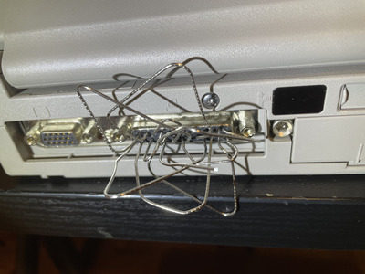

I recently picked up a cheap Toshiba 490xcdt (p2 era) and Toshiba Tecra 8000. The 490xcdt had the bios password. Removed both cmos batteries and hard drive, bios password still stays (? eeprom).
ANYWAYS, was going to build a parallel port bypass device (soldering/twisting wires) but read somewhere about someone just tying some wires together that made me think.... Why not just jumper the port directly?
Using paper clips, a right angle wire cutter (to clip the paperclips shorter/cleanly where needed); I was able to wire it up and get it working. I made a video but need to edit it... The only tricky one was the 1-5-10 triple cable which I wired by having a 2nd wire/paperclip touch the one in the 1-10 port.
Anyways, I've uploaded a picture. Works great and saves people from having to buy/build devices to use one off.

Glad I found this thread as I've been trying to reset the BIOS password on a recently acquired Satellite 320CDT. The eBay seller neglected to mention this, but to be fair it was sold as Spares/Repair.
I had tried various things including generic passwords and a "key disc" but that hadn't worked. I had heard about the parallel port hack, but was sceptical. kleung21's photol inspired me to give it a try with paper clips and can confirm it worked for this particular model.
    54.51 KiB
    8881 views
    Toshiba Satellite 320CDT Parallel Port Hack

The parallel port method also worked on my 310CDT. Used some solder wires as I didn't have enough paper clips. 😀
For future reference note where pin 1 is located. Above pics worked perfectly. First time I mirrored it the wrong way as I looked at another guide without pics. No harm was done but it didn't work of course.
