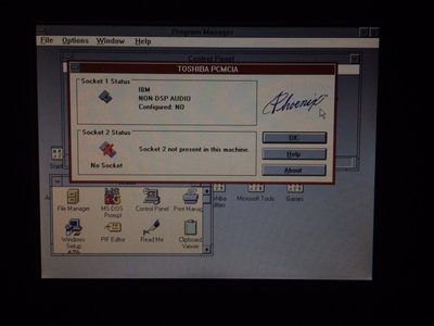

I have a Toshiba T3400CT with DOS 6.00 and Windows 3.1. Only problem is, as good as I am with Windows 95 to anything modern, Windows 3.X is a little before my time and I'm a bit stumped. I'd like to use the PCMCIA slot . I have obtained a couple of cards I believe should work nicely; a 3com EtherLink III LAN PC Card (3C589C) and a DELL Audio PCMCIA card Type CB-001. I believe the latter to be a rebranded IBM 3D Sound card as it says Assembled in Canada, Made for Dell by IBM.
I have two problems, one is a complete lack of correct drivers and the other is a complete lack of knowledge of how to install PCMCIA devices in Windows 3.1. Any help in both regards appreciated please.
So far, if I plug in the the cards, the Toshiba/Phoenix PCMCIA utility in control panel reports the following:
The 3com card:
Socket 1 status - 3Com Corporation - 3C589 - Configured: NO
The Dell audio card:
Socket 1 status - IBM - NON-DSP AUDIO - Configured: NO

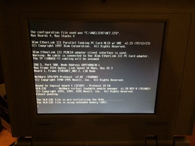

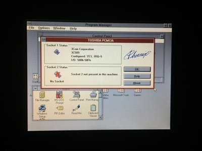

Ok, thank you cyclone3d, those 3com drivers appear to be working. I need to install the TCP/IP stack now and see if I can get network access up and running.
Nice find on the Dell audio drivers. It was fun getting them onto something I could write the floppy image to though as they're not standard format images and the dcopy utility would only run on old Windows. I'll have to convert them to something a bit easier and re-upload them. I'm still struggling with the resource conflict though and no idea how to resolve it.

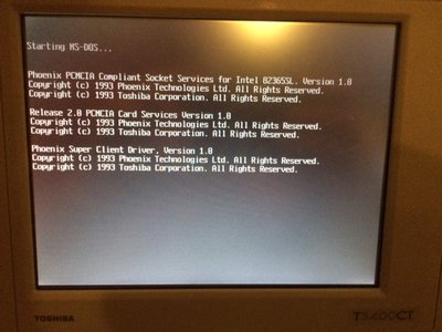

Thank you dr.ido. Yes, the drivers for the PCMCIA controller do appear to be installed. Re. the drivers, this is the original factory install of Windows 3.1 so has all the drivers ready loaded. I even have the Toshiba restore floppy images still on the drive so I'd bet the drivers are in as part of those. I have backed up the entire drive before I started messing with it (V-Sign virus included but don't worry it's only in the mbr of the disk image not any files. I've checked thoroughly.) and intend to upload all the floppy restore images for archival at some point. Here are some photos showing stuff (PCMCIA and 3com network card) loading on boot.

Here is a photograph of the 3com card loaded and also of the audio card failing to load.

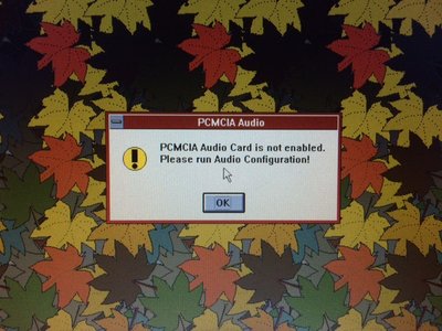

Because of the problems allocating resources, I get the following message when Windows loads.

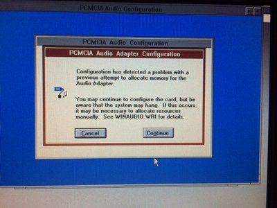

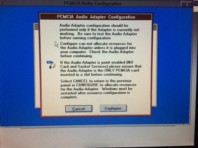

Reply 7 of 13, by mikeyp

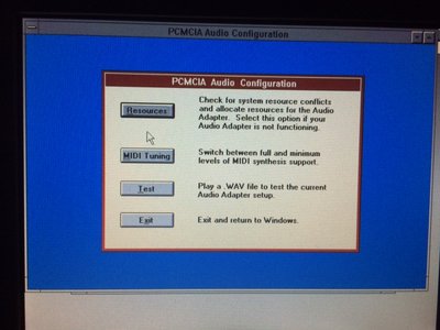

Running Audio configuration produces the following dialogues, after the last of which it hangs, though can be recovered with Ctrl-Alt-Del, then press enter to close the program. Obviously this leaves it still unconfigured.
104.33 KiB
735 views
129.94 KiB
735 views
113.95 KiB
735 views
It then suggests I look in WINAUDIO.WRI and attempt to configure it manually but this is where I have *no idea* what I'm doing. Here's a pdf conversion of WINAUDIO.WRI

Reply 8 of 13, by cyclone3d
This is the section in the document that is for manual configuration:
Manual Resource Configuration
The Audio Configuration program will attempt to detect conflicts between the Audio Adapter and
other system components with respect to memory and I/O ports. It is possible that your computer
has a memory or I/O port conflict that is beyond the scope of Audio Configuration. In this case,
you will have to manually allocate resources for the Audio Adapter. After any change in the
WINAUDIO.INI file Windows must be restarted for your change to take effect. Before performing
any manual configuration of the card, it is recommended that you allow Audio Configuration to
attempt resource allocation.
Resources for the Audio Adapter are specified in the WINAUDIO.INI file in your WINDOWS
directory. The relevant sections of the file and valid entries are:
[IO_Ports]
Range1_Start=0x250 < valid entries: 0x250, 0x650, 0xA50, 0xE50 >
Range1_End=0x25F < valid entries: 0x25F, 0x65F, 0xA5F, 0xE5F >
Range2_Start=0x340 < valid entries: 0x340, 0x740, 0xB40, 0xF40 >
Range2_End= 0x347 < valid entries: 0x347, 0x747, 0xB47, 0xF47 >
[Memory]
Range1_Start=0xCF00 < valid entries: 0xCF00, 0xDF00, 0xEF00, 0 >
Range1_End=0xCFFF < valid entries: 0xCFFF, 0xDFFF, 0xEFFF, 0 >
The "0x" in front of each value denotes a hexadecimal number. Note that when Card and Socket
Services are installed the [Memory] section will have 0 for both start and end values since no
memory window is required in this environment. If Setup/Configuration was not able to allocate
I/O ports all four values in the [IO_Ports] section will be 0, as will the entries in the [Memory]
section if the Audio Adapter is point enabled and no free memory window was located.
So first of all, look in Winaudio.INI and see what the specified settings in there say.

PCMPLUS is the PCMCIA software, socket services, card services etc. See first screenshot above.
Agreed about the EMM386 exclusions but a little scared to take stuff out for fear of breaking it. I know C800-C8FF is required by Toshiba Card Manager. Do I need the second EMM386 line under [STANDALONE]?
I believe card services is installed as per the first screenshot above on boot.
