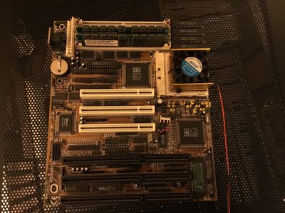

The onboard IDE ports on my Lucky Star LS-486 are not working right.

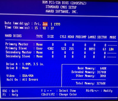

When I select to “Detect Hard-drive” in bios the Hard-drive turns up as a slave.
The Selector pin on the hard-drive is setup to Cable Select, I also tried Master and that did not change anything.
Hard-drive is a NEW WD-5420 540mb IDE hard-drive.
I am using NEW IDE cables and I already swapped them out twice.
The bios setting do not hold and after I select save in bios it restarts with no drives selected /
Hard drive settings in bios do not hold after restart.
New battery, All other setting remain the same just the hard-drive settings do not hold.
What do you think could be wrong ?
IDE Cables ?

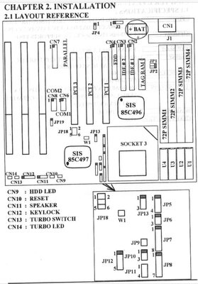

See this photo and tell me what jumper “W1” is for ?
Also does anyone know if there is a Clear CMOS jumper on this motherboard ( lucky star LS-486e , rev. C ?
I need to know what jumpers JP19, JP13 and W1 are for ?

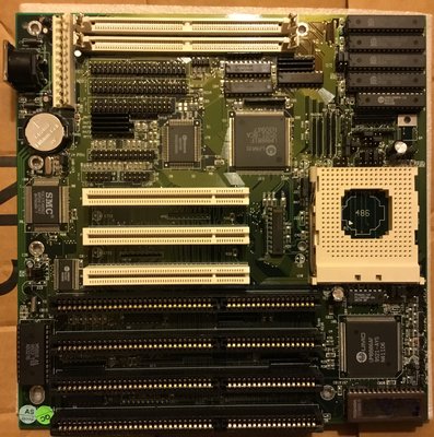

Reply 14 of 23, by Intel486dx33
Okay, I tried this same setup with a different motherboard and same results.
So the problem is not the motherboard but either IDE ribbons, or CD, or floppy drive ?
The CDROM works fine when booting off a DOS boot floppy.
Floppy drive seems to work fine.
It’s just the hard-drive that comes up as a slave drive. But when I save setting in bios and restart from boot drive
And perform fdisk, No drive found error message appears.
The Hard-drive settings do not retain. So NO drive found.
I am confused. I have tried different motherboards, ribbons, and drives with the same results.
Any Ideas ?

Reply 19 of 23, by dionb
Intel486dx33 wrote:
I don’t know what is wrong. I tried everything. I can’t get these 486 motherboards to work with these IDE drives.
Everything?
Twice now you've been told that Cable Select will NOT work with a single drive on the cable if that drive differentiates between "Single" and "Master" settings, as your drive probably does. You haven't mentioned anything about trying that and just keep repeating that you set to Cable Select. Have you tried setting it to "Single Drive" instead of Cable Select?
