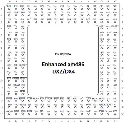

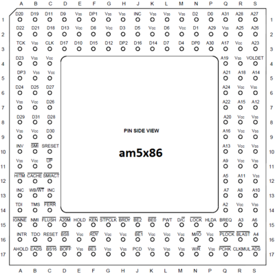

I can't get L2 cache work in this motherboard with a am5x86 CPU and I have no clue why is that, L2 works perfectly fine with am486DX4. I have compared both of these CPUs pinouts and according to the datasheets - both are identical in pinout 😕 Has anyone dealt with this problem before?

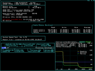

Speedsys results, am5x86 @ 163MHz in 3x mode:
