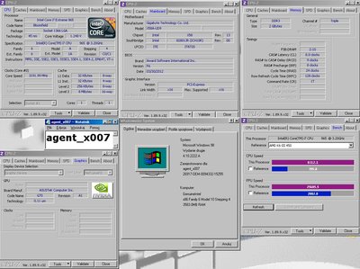

348.11 KiB
1563 views
Awesome job again, thank you 😀
Q: Will it work on D0 revision as well, or is this C0/C1 only fix ?

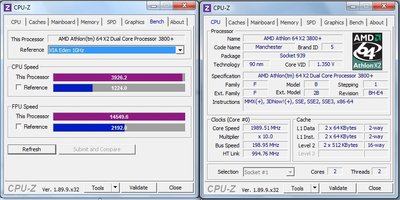

Reply 146 of 437, by PC@LIVE
Hi, as soon as I can I have to try it on the old PC of my collection, I thought it only worked with win95, instead it works also with W.XP and W.7.
I tried it on my Internet PC:
HP MSI Amethyst-M 1.0 ATi Radeon Xpress 200
AMD Athlon64 X2 3800+
Bestec 300W
Corsair 4GB DDR400
HD WD 40GB SATA
S.O. W.7
I include an image.
Soon I will try on the Pentium Pro 200.
    145.24 KiB
    1495 views

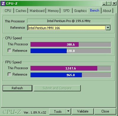

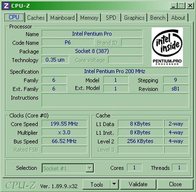

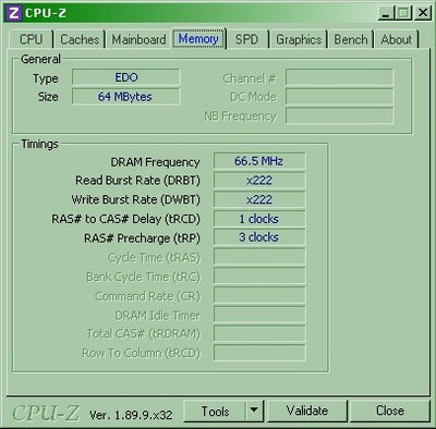

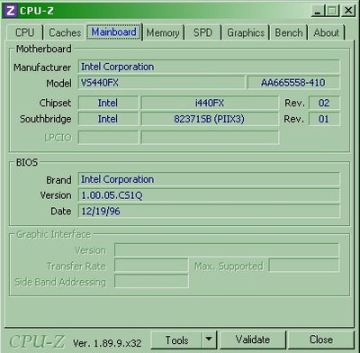

Reply 147 of 437, by PC@LIVE
Bench PentiumPro 200MHz
    39.57 KiB
    1469 views
    38.85 KiB
    1469 views
    40.13 KiB
    1469 views
    39.1 KiB
    1469 views
    54.19 KiB
    1469 views

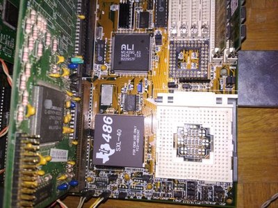

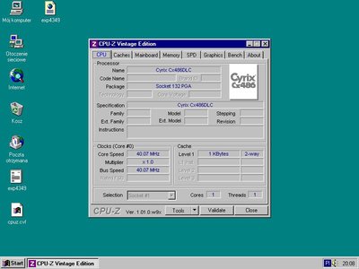

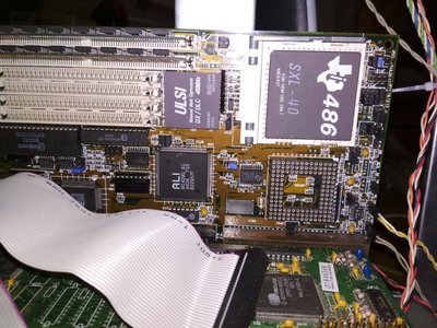

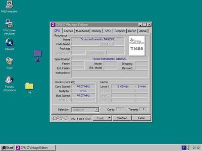

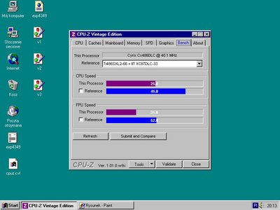

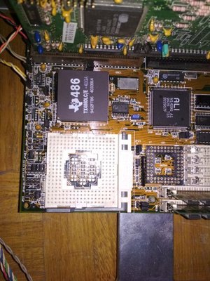

Reply 153 of 437, by PiotrUU
Hi,
Ti486sxl PGA168 + ULSI FPU @ exp4349
    55.27 KiB
    1099 views
    208.13 KiB
    1099 views
    59.84 KiB
    1099 views
Reply 154 of 437, by CuPid
Thanks PiotrUU. I've improved things to make the detection of the SXL better, can you please give it a try and let me know ?
http://download.cpuid.com/betas/cpuz_w95.zip
Thanks 😀

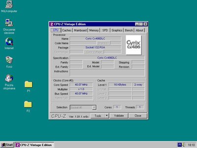

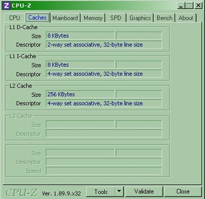

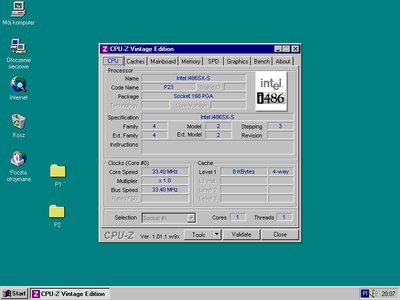

Reply 155 of 437, by PiotrUU
I did some tests. Win95 did not work with cx486s (M5) and cx486dx (M6) on exp4349 !!
WIN95 with CPU cx486dx2 (M7) works.
I send results via email.

Reply 156 of 437, by CuPid
Thank you PiotrUU.
It is indeed strange that the DX2 works and not the DX nor the S. Are you use that they are working ?
The SXL is detected as a DLC with a 16-KByte L1 😵. The cache detection routine is wrong because it is designed to detect 4-way caches, and I think the SXL uses a 8-KByte 2-way cache.
Anyway, that version should work OK on the SXL.
Also, the validation should work too, another problem was fixed on that side.

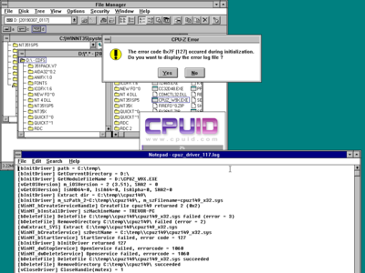

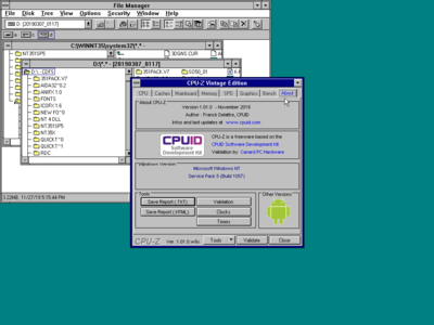

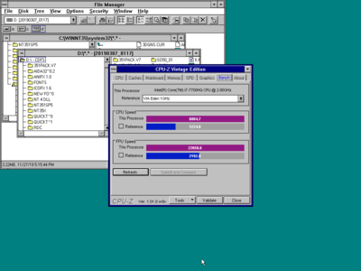

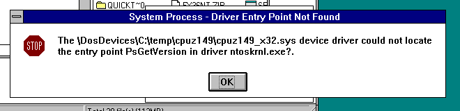

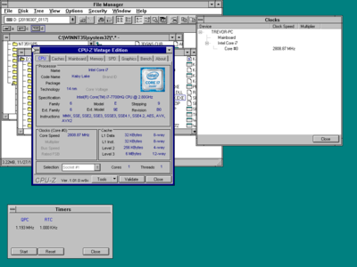

Reply 159 of 437, by Carlos S. M.
Tried CPU-Z Vintage Edition on NT 3.51 (running on a VM) with SP5, some updates and VC++ 6.0 libraries, throws an error about a missing function about OS version, but starts.
Will try some older hardware later on 9x or NT 4.
54.47 KiB
981 views
main window
39.32 KiB
981 views
bench
47.46 KiB
981 views
About window
Edit: errors found
6.08 KiB
981 views
first error
62.49 KiB
981 views
second error
