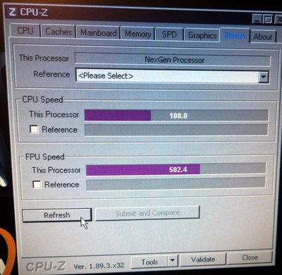

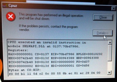

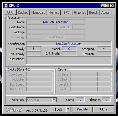

Reply 19 of 459, by feipoa
Attached is the report for a NexGen PF110 running Windows 95c. Currently posting using Opera 8.53 from the NexGen system, so hopefully the files will submit properly.
The attachment NEXGEN-W95.PNG is no longer available
The attachment w95c_Benchmark.jpg is no longer available
The attachment NEXGEN-W95.txt is no longer available
I should point out that IDON.COM needs to be set for CPU-Z to run properly, otherwise you receive this error:
The attachment w95c_error_for_no_IDON.jpg is no longer available
You can learn more about IDON.COM and IDOFF.COM at http://www.cpu-world.com/forum/viewtopic.php?t=31984 and to a lesser extent, here: Help getting my NexGen system online
