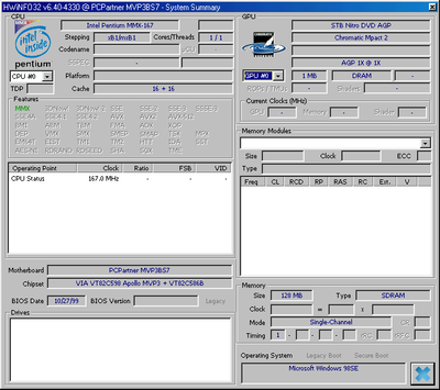

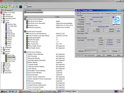

Reply 461 of 683, by Takedasun
STB Nitro DVD 4MB AGP (Chromatic Mpact 2).
25.92 KiB
2055 views
61.25 KiB
2055 views
    HWiNFO32.zip
    5.29 KiB
    68 downloads

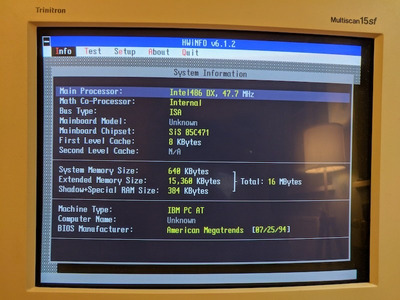

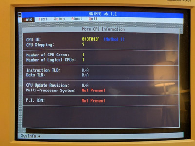

Reply 463 of 683, by mbertheau
I have a 486 DX4 100 that shows up as 50 MHz in HWINFO 6.12:
104.95 KiB
2031 views
94.28 KiB
2031 views
During bootup the Bios screen indicates the correct 100 MHz.

Reply 465 of 683, by mbertheau
mbertheau wrote on 2021-01-10, 00:28:
Ok, disregard that. I had the computer out of the case on the table and the turbo was off 😀 It's showing 100 MHz now with the turbo on. And Warcraft 2 runs nicely fast 😀
