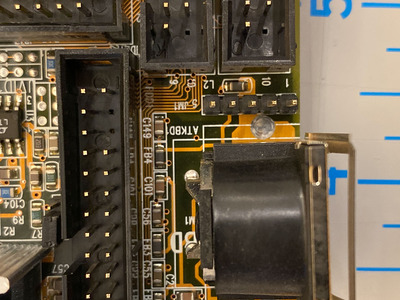

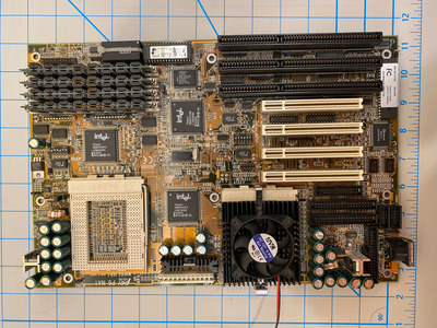

I have dual PPro motherboard MS-6103 that has a 5pin header for PS/2 connector right next to the DIN AT keyboard connector. Can anyone recommend a way to add a PS/2 header to it on a ribbon cable so that I can connect PS/2 mouse or keyboard to it. The motherboard documentation doesn't provide any specs around what each pin of the header is. Was there a standard for these type of headers?

That PS/2 header is just for the mouse, and for the pinout you'll have to look in the manual, since those headers at the time weren't really standardized

With the board removed, use a meter to probe the pins. You will find at least one pin connected to ground, one to a +5V rail. The remaining pins you have to guess at. Try each possible combo until your mouse works. It shouldn't hurt anything if you get the data and clock lines wrong. You'll likely find the extra pin is either ground or not connected.

For ps2 mouse just 4 pins are used:
6-Wire Layout
PIN SIGNAL COLOR
Pin 1 Mouse Data Brown
Pin 2 Reserved Open
Pin 3 Ground Red
Pin 4 +5V Yellow
Pin 5 Mouse Clock Green
Pin 6 Reserved Open
Since you just have 5 pins in one line ignore the pin 6 (that is NC anyway).
