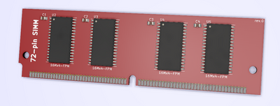

72-pin SIMM template, if anyone wants to use it.
262.33 KiB
876 views
https://github.com/wiretap-retro/72-pin-SIMM-KiCAD-Template
