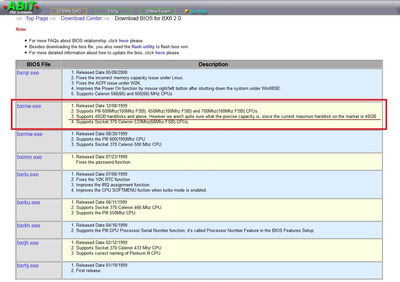

This has been a nightmare trying to get this retro build up and going- between ordering parts internationally or getting stuff that doesn’t work (the usual hassle) this is my first windows 98 build in 20 years and it’s all the headaches I remember..
Today, I got a replacement motherboard it’s an ABIT BX-6 2.0, and the issue that I am currently facing is that it refuses to detect my IDE drives, These drives were pulled from a working machine just weeks ago, the IDE cables are also from that said machine- they’ve been properly jumpered to the pri/master slave configuration and are set on IDE Channel 2- the dvd cdrw combination drive is on IDE Channel 1 and is immediately detected in the bios- now I have tried every single configuration of moving the drives from ch1 ma/slv , 1 drive, both drives, etc... the molex adapters are good and working in the machine, the cables have been swapped to the working dvd rom to verify that they’re working, i am at my wits end here with this build and trying to find info on the older hardware has been almost fruitless... i even thought of trying to find the information on the drive and adding it in the bios myself but no, as I cannot find it even on the spec sheets for the drives. The drives in question are a Western Digital WD400 40gb, Maxtor Diamond Max16 80gb and a Seagate 120gb- model number is unknown due to laziness, sorry.
Tl;dr I have 3 ide hard drives that are not being read by a computers bios and a cd/dvd rom drive is
Really any help is appreciated

This a PII 440BX motherboard, right? Don't just assume it can detect hard disks 40GB+. Common sizes back then were times smaller. I'd try a smaller disk and a BIOS update, many motherboards of that era had the 32GB limit. Another thing to check is if one of your drives has a jumper to limit its capacity to 32GB and try it like that

Yes of course it's not a chipset limit. The point I wanted to make is that motherboards of the PII/44oBX/"that" era don't always support disks larger than 32GBs. Many did through a BIOS update though.

I apparently do not have either a -a working floppy drive or b - a good floppy disk, I tried updating the bios by slamming the file in a bootable dos 6.22 ISO but no such luck.. the outdated bios seems reasonable as on the boot screen it says 1.0.
I will attempt to obtain a disk less than 32gb in the next few days, parts like that are very scarce here as either nobody bought the technology or it’s all been recycled away. I also need some decent floppies too ha!

Finding a working bios for your motherboard is usually a better solution. Glad you found one.
