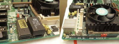

I have this photo I saved from some site ~15 years ago, and I'm trying to figure out what model of what manufacturer the motherboard is.
242.4 KiB
1077 views
It's clearly Socket 5/7 (the Intel box cooler of that period gives that away), and Baby AT with green-coloured PCB. The large VRM sinks, Seagate 4500RPM HDD, PS/2 mouse bracket attachment, and onboard I/O point to something with 430VX from ~1996 (at least to me). There are at least four ISAs, at least two PCIs, a "VIA-II" keyboard controller, and one of those Dallas-type self-contained battery things. I've yet to see a match come up searching terms in Google Images.
Anybody have any idea?

That's very, very little to go on.
What I'd do: the most noticeable feature is the RTC location, not horizontal along the bottom as usual, but vertical in front of the ISA slots. If I really wanted to ID this, I'd open up TH'99 and manually go through all the Pentium boards looking for AT boards with >=4 ISA slots and an RTC in front of them. Would take an hour or two, and I'm afraid I can't be bothered now to do it for you - but it's your best shot IMHO.

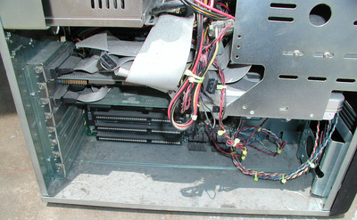

Reply 3 of 13, by PC Hoarder Patrol
That thought occured too re. the RTC - maybe some Shuttle board like this HOT-533

Reply 4 of 13, by PARKE
Looks like DFI G586IPV
https://www.cbo-do.de/Motherboards/Intel/Inte … tml?language=en
edit: G586IPV just "looks like it" but isn't exactly the same - G586IPC looks spot on.

Reply 5 of 13, by SW-SSG
dionb wrote on 2020-06-09, 22:40:
... If I really wanted to ID this, I'd open up TH'99 and manually go through all the Pentium boards looking for AT boards with >=4 ISA slots and an RTC in front of them. ...
Thanks, I did just that and managed to find it within (luckily) ~20min. It's the DFI G586IPC. Turns out it's a 430HX...
There's some good photos of one on *bay ATM. Date codes are pointing to early 1997 for that one.

Reply 11 of 13, by Deksor
I don't think it's that DFI.
If you look closer you'll see that your pentium had 4 ISA slots while this dfi only has three, and the DALLAS battery is somewhere else.

Reply 13 of 13, by Deksor
Ah nevermind I was talking about PARKE's post but I didn't see that SW-SSG actually found a different model which indeed looks like the one in the photo.
For the manual, you can find many versions of it here : http://www.elhvb.com/mobokive/Archive/Dfi/man … 6ipc/index.html.
