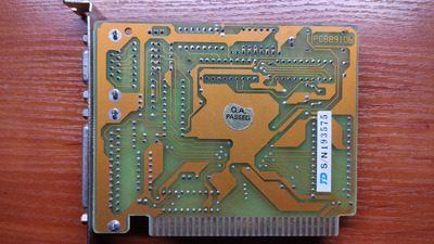

#19
Manufacturer/Identifier: Citygate
Chipset: Citygate D10
BIOS-String: IBM COMPATIBLE.*EGA BIOS V1.6a COPYRIGHT Award Software Inc.
Status: Card is untested
1.95 MiB
428 views
1.95 MiB
428 views
DIP Switches:
1--2--3--4
on-off-off-on = 40x25 Color monitor
off-off-off-on = 80x25 Color monitor
on-on-on-off = Enhanced Color Display, CGA emulation
off-on-on-off = Enhanced Color Display, Hi-Res
on-off-on-off = Mono Monitor + CGA 40x25
off-off-on-off = Mono Monitor + CGA 80x25
5 --6 is LPT on/off and address selector (3BCh/378h)
JP1
1-2 EGA monitor
2-3 CGA/Monochrome monitor
JP2
ISA pin A1 - I/O channel check report
EGA - Citygate D10 D27256.bin.zip
8.41 KiB
38 downloads
Notes: The ROM type specified on a silkscreen is 27128, but the card had 27256 and the bios image was duplicated in upper half of the chip.

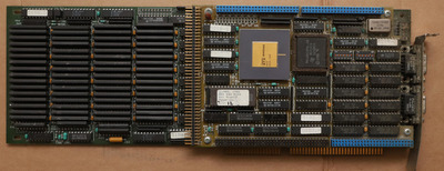

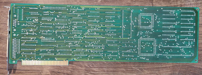

Reply 22 of 26, by Predator99
#21

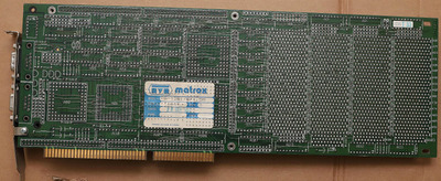

Manufacturer/Identifier: Matrox PG-1281
Chipset: TMS34010 TIGA
BIOS-String: PG1281 EGA/CGA emulation BIOS ROM Copyright (c) MATROX Electronics Systems, Ltd April 06, 1988
TMS27C512
Matrox PG-1281.zip
1.04 MiB
12 downloads
1.03 MiB
238 views
1.27 MiB
238 views

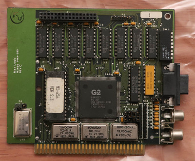

Reply 23 of 26, by Predator99
#22

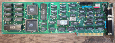

Manufacturer/Identifier: Max Logic MX656 PWA-385
Chipset: G2 GC 201
BIOS-String: GEMINI VC-001 IBM COMPATIBLE EGA BIOS (V2.3 ), Copyright (C) Gemini Technology Inc 1987-1988
Status: untested
EGA-MX656.zip
787.93 KiB
13 downloads
780.95 KiB
205 views

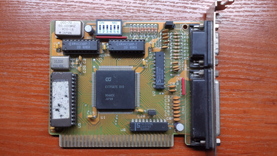

I'd like to offer an update to #14 since I have one (it seems to be called "PA-WTEGA").
The BIOS dump matches mine and I read the EPROM using external programmer. There's a project that re-created the PCB (and full schematic) so anyone can build it provided they have the chips, and the DIPs have been figured out:
The card has a bank of 5 dipswitches.
Dipswitch 1-4 select the card video output mode:
0-1-0-0: MDA Mode (main)
1-0-0-1: CGA 40x25 (main)
1-0-0-0: CGA 80x25 (main)
0-1-1-1: EGA 200 lines (main)
0-1-1-0: EGA 350 lines (main)
1-1-1-1: CGA 40x25 (secondary)
1-1-1-0: CGA 80x25 (secondary)
1-1-0-1: EGA 200 lines (secondary)
1-1-0-0: EGA 350 lines (secondary)
Dipswitch 5 selects the IO address:
0: I/O address range in 3xx (default)
1: I/O address range in 2xx
0 means switch open, 1 means closed.
I don't have EGA/CGA monitor to test it, only a mono MDA/Hercules one that does accept 60Hz CGA input and shows colors as different intensity. I tried MDA emulation and CGA modes, it all seems to work properly with my monitor.

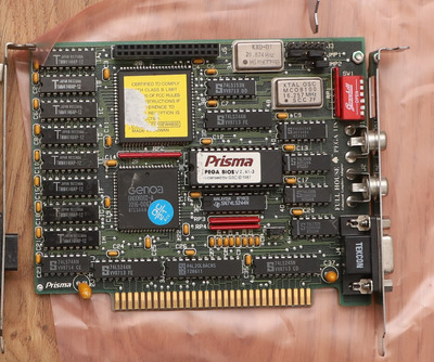

Reply 25 of 26, by Predator99
#23
Manufacturer/Identifier: Prisma PEGA FULL HOUSE Enhanced Graphics Adpapter
Chipset: Genoa GN006002-A
BIOS-String: Prisma PEGA BIOS V 2.41-3 (C) copyright GENOA Systems Corp.09/30/86
EGA-PrismaFull House PEGA.zip
523.65 KiB
11 downloads
505.45 KiB
168 views

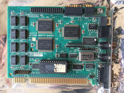

Reply 26 of 26, by Horun
#24
Manufacturer/Identifier: Renaissance Legacy II, Switching Graphics Adapter
Chipset: Yamaha FC6480 +VC6481
BIOS-String: Legacy II bios V1.00a Copyright (c) Renaissance GRX, Inc
IBM COMPATIBLE.*EGA BIOS V1.6 COPYRIGHT Award Software Inc.
BIOS CHIP: tmm24256ap Toshiba, 28pin DIP 32k x 8 PROM (Pin compatible with TC53257P, TMM23256P, EPROM TMM27256D/AD, TC57256D and most 27256)
Status: Card worked in 2019
Notes: This is an EGA, CGA, MDA and Herc adapter. Has 9pin DIN, two RCA and MS Mouse InPort.
Switches/Jumpers: Lost the .txt file a decade ago, currently set to EGA mode iirc 🙁
    753.14 KiB
    74 views
    LegacyII.7z
    8.35 KiB
    6 downloads
    BIOS
