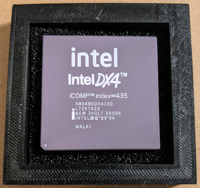

I won the auction on the one I bid on... thanks to all for not bidding.
I received it a couple days ago and just tested it in my PC-Chips M912 v1.4 motherboard and it works just fine. This is the motherboard that is in use in one of my builds. First and only board I have tried it on.
I had an Intel Overdrive DX4-75 running at 100Mhz before this.
All I did was change the voltage settings from 5v to 3.3v before testing for boot.... well, besides also putting a heatsink/fan on the new CPU.
It booted up but locked at the Windows 98SE boot screen.
I then rebooted and hit F8 to bring up the boot menu and booted to a DOS command prompt.

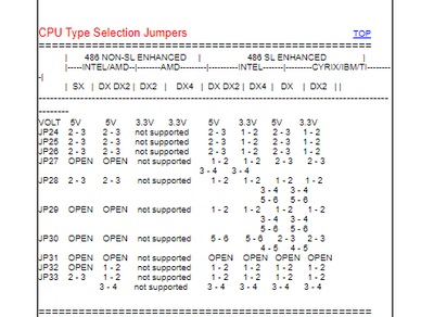

After looking at the jumper chart again, I saw that there were jumpers that needed to be set for the SL Enhanced CPUs so I set those.
After that it booted up into Windows 98SE fine.
So, I can confirm that these CPUs are not fake. Guessing the OP of the original thread just doesn't have a motherboard that is compatible with them.
Pics of the CPU that was sent to me:

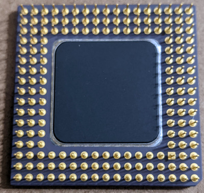

Yes, that is a 3D-printed enclosure around the foam. Seems like an awful lot of trouble to go to to protect a "fake" less than $9 CPU.

Not related to the OPs issue but to the hardware.. I also have a m912 v1.4 and after reading that your dx4 worked decided to go on another search as to why mine doesnt.... V1.4 does not support AMD dx4 😀
Could have saved myself an hour if I had found a 1.4 manual sooner (was using 1.7)

We've confirmed it's a working 486 capable of running at the specs advertised. That's a big step, but doesn't rule out re-marking of a recycled CPU (another kind of faking). What happens if you rub top and/or bottom with acetone?

Are you going to remove the die cap to see if it matches the design of other DX4-100's?
Please post benchmark results as well, it would be interesting to see if there are any differences or enhancements on this chip compared to old ones. CPU-Z or CPU ID would also be neat to compare.
Well, the die cap is larger than the older CPUs so it can't be a remarked older CPU unless they put another die cap on top of the original one.
Since the top is painted and not etched, wouldn't Acetone probably remove it regardless?... guess I could try in a corner and see what happens.
I'll have to get some Acetone first since I ran out a while ago.

wiretap wrote on 2020-09-21, 11:45:
That's good news and confirms that there must just be quite a number of DoA chips in the batch he was selling. (or several people didn't have correct mobo's) I'm glad the controversy has been cleared up and it is not counterfeit. I sent an Ebay message with this thread link to the same place I initially did, but I'm not sure where it goes or if Ebay even cares. I doubt the seller sees it.
Well.. since it works, I don't really want to take the die cap off.
I'll post benchmarks when I get a chance though.

Maybe this video I recently stumbled upon helps (how to identify fake Pentiums): https://www.youtube.com/watch?v=wsKjX6UGYUQ
If the chip is somehow reprinted you usually don't get the typical very sharp 45° chamfered edges on the ceramic package.
On the other hand ... the intel marking is indeed suspicious (no lower "e" and no (c) or (tm)) - there's also various forum posts dating back to 2010 assuming those as fakes.

LewisRaz wrote on 2020-09-21, 08:52:
Really ? I have two v1.4 and they could run a amd 5x86 and I'm sure it also ran a amd dx4 !
Reply 17 of 31, by LewisRaz
Deksor wrote on 2020-09-21, 16:13:
Yep! Its officially not supported... Although perhaps it would of worked if a tired and poorly me had not left the jumpers on 25mhz..? 😀
Might try again soon.
