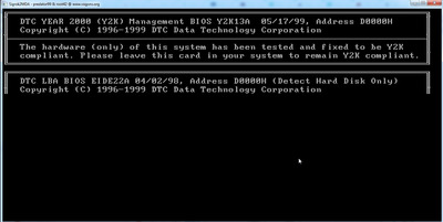

Several people asked me for the rom. These cards are rare. I used NSSI in to back it up. Let me know if its not right.

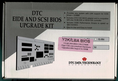

Reply 1 of 24, by Warlord
more

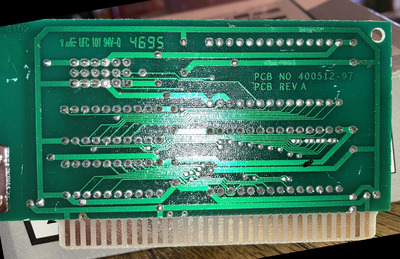

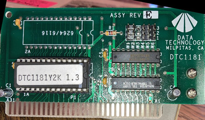

Reply 2 of 24, by Warlord
card

Thank you !
added: the ROM file looks good. Contains DTC LBA BIOS EIDE22A 04/02/98, and DTC YEAR 2000 (Y2K) Management BIOS Y2K13A 05/17/99.
The PAL may be tricky to dupe but the 27C256-15 EPROM and 74LS245 are common, might be possible to build one by some reverse engineering.
Am still trying to figure out why mine has that 2kx8 (16K) CMOS Static RAM chip, maybe the EDPT10A bios on mine needs it for some reason.

Think there is no need to clone the card, the BIOS should run from a network card? Will test this later...
Reply 7 of 24, by Warlord
well it has jumpers to change address, and to enable disable, It also have some jumpers that say factory don't change. Without that idk how well it will run in a network card if at all. Idk what those 2 chips too the right are for either.
Reply 8 of 24, by Horun
Yeah somewhere is my stack-o-crap have a few ISA jumper set old NIC's, think the BIOS might work in one of those but probably not in a software programmed one. I will find a flash chip and burn the rom for my DTC1181 some time soon
Reply 9 of 24, by Warlord
worked?

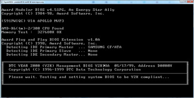

Reply 10 of 24, by Predator99
Yes, starts from a network card - thanks again!
The attachment DTC1.jpg is no longer available
The attachment dtc2.jpg is no longer available
Most probably is to save the updated Y2k year structure, in order to don't f*ck with system clock chip, which would have no space in its CMOS ram to store the fixed year info.

And does it detect your harddisk?
Good question. I was not able to see that part, think because the System BIOS cleares the screen to show the config table too fast. Maybe I should try to switch off the HDD detection in the BIOS and see if it boots anyway.
There maybe a problem with some NICs not supporting 16kb ROMs. I have seen several where you only can put 2kb in. I used a 3COM 16-bit card.
