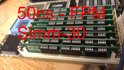

I just made the fastest possible (50ns), FPM (Fast Page Mode), Simm-30 memory modules with parity functionality.
I have no idea if something like that was ever produced.
I have never seen FPM modules faster than 60ns.
-> Custom, brand new, professionally done PCBs.
-> High quality 50ns Infineon chips (New-Old-Stock).
-> Parity functionality included and working.
-> 4MB modules, for 16MB per kit of 4.
Unfortunately (and probably as expected), until now I have not found any way to push these modules to the limit.
My 386, 486 collection is very limited and with my boards even with generic 60ns modules you can basically max-out all settings.
Is there anyone here that is limited by the standard 60ns modules?

Reply 9 of 47, by galanopu
As I said in the video, for now I only have a few 4x4MB kits.
To be exact 5 of them. I want to keep 2 for myself. So 3 are available.
I will only do one kit per person for now and ideally to people that can really use them.
I would probably make more in the end, but the stock for these chips is questionable.
Now regarding pricing.
These are premium 50ns modules. No one sells something like that so I can not compare.
I am located in Europe. The cheapest kits I see in ebay are at 32e and these are 70ns.
To my understating, one previews attempt here in Vogons was at 36e per kit (60ns, no parity chip).
So I am thinking that 60e for these kits is a fair price (15e per 4M module).
This might sound high to some people, but in the end these are not your standard modules.

Reply 10 of 47, by galanopu
Good news guys.
I found stock on some sick 40ns FPM 5v 1Mb chips.
So in about 1 month from now...
if everything goes well...
expect some 1MB simm-30 40ns FPM modules from me.
The drawback is that I will have to skip the parity chip this time 😒
I know this is a problem with some boards... but well, this is 40ns FPM :p

Reply 16 of 47, by galanopu
Form what I have read... some 3 chip versions have problems with some very old M/B.
But the problem is usually with the parity function and this makes sense as the 3rd chip is different and has marginally different timings.
Now from an electrical point of view... 8x1Mx1 or 2x1Mx4... I do not think any motherboard can understand the difference.
The only potential problem is if the 1Mx4 are just newer chips and have extra type of transfer / refresh cycle that is not supported by older M/Bs.
Now what I am gone try here... is test my luck with some 1Mx8bit chips!
So a single chip per module and probably the only way to get 40ns.
That is why the first batch will be again only 20 modules. Worst case I will blew a few 100e here.
I am also in contact with the "cpu galaxy" youtube channel. We live in the same city. He is a very nice guy.
So he can give me probably some more old M/Bs for testings these or I will give him some of these for testing. :p

Reply 18 of 47, by galanopu
Yes this is true! I did my research earier today.
All the 1Mx1 chips I checked were organised differently (9 x 11 bits), with sorter refresh cycles (512).
So unless the M/B refreshes up to the 10th bit this will not work with 1Mx4 or 1Mx8 chips (that are 10 x 10 bits).
Newer motherboards also support auto-refresh, so there is never a problem there.
In the end I also found stock of some 1Mx1 50ns chips.
The problem is that if I make 9-chip 1MB modules this will cost significantly more.
I will probably make them either-way for comparison.
However if I sell them these would be very expensive!
