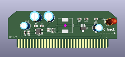

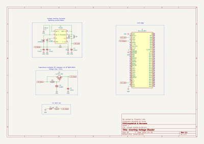

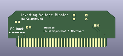

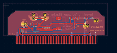

Reply 45 of 59, by CalamityLime
Hey there,
I don't know if this is the place to post this but eh, why not.
I felt like making a circuit with an inverting buck regulator for some fun, plus to learn something about them and ripple rejection. I took the voltage blaster and replaced the lm7905 with an inverting regulator with a capacitance multiplier to cut out noise hopefully within the range of human hearing.
It should be able to make -5v@100ma well enough and hopefully quiet enough to not be audible on your sound card. Everything in this is a first for me, first time laying out a circuit with a switching regulator and first time using a capacitance multiplier. So if I messed up, point it out nicely please.
I'm not sure if this is really worthwhile over an lm7905 but it was primarily an exercise for me.
In case it's any good to anyone, here is a github with the kicad project files: https://github.com/LimeProgramming/InvertingVoltageBlaster
Just a reminder, that this is obviously untested and may not work.
-Thanks

Reply 46 of 59, by Sphere478
Ok wow. Very nice! :p can you make a 3.3v pci edge style version? Some mobos required a card for injecting 3.3v into the pci slot to power the cpu. (Weird, I know)
