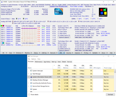

I just built an Intel D5400XS (Skulltrail) system and the interrupt load is much higher than I would expect. Has anyone else seen this and/or know how to fix it please? I initially noticed this as SIV showed it for CPU-0, it's not down to SIV as it was still there when I exited SIV.
file.php?id=103944
I have the BIOS XS54010J.86A.1353.2009.0724.1139 07/24/2009 is there a later one?

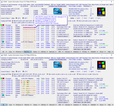

file.php?id=104088
I finally have a handle on the high Interrupt load and it seems to be related to the GTX 460 drivers, above the top screen is using latest 391.35 and the lower one is from before I installed the GPU drivers, note how the interrupt load on CPU-0 is different.
I tried 2 x GTX 285 with the latest 342.01 drivers and quickly gave up on those after a couple of BSODs 🙁
I would like to know what GPUs are driver versions other D5400XS owners use and if they also get the high interrupt load ideally when running Windows 10 x64 Build 19042.
