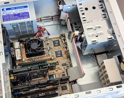

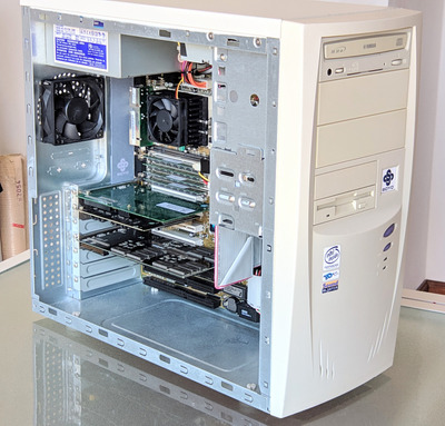

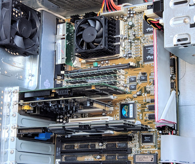

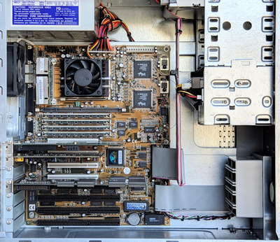

SOCKET 8 BUILD with upgraded components and some benchmarks
CPU - Pentium Pro 200MHz 256Kb L2 cache (late 1995)
Motherboard - Soyo 6FA (mid 1996)
RAM - 4 x 16MB EDO DRAM 60ns
Graphics - Creative 3DLabs Permedia 2 4MB (1997)
Sound card - SB Live! CT4760 (1999)
3D graphics - Skywell 3D Magic II 3Dfx Voodoo 2 12MB (1998)
HDD - Samsung 10GB IDE
CD-RW - Yamaha CRW2100
Unfortunately, the motherboard ISA connectors don't detect any sound card. Everything else works fine on the motherboard. That's why i'm using a PCI sound card.

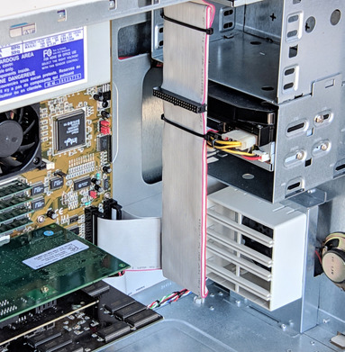

Reply 2 of 11, by rcarkk
vetz wrote on 2021-04-05, 10:25:
Nice cable management. How did you get those ATA cables aligned so well?
I used cardboard and dual sided tape

Reply 3 of 11, by chinny22
I think I need help, that ATA cable is very pleasing to look at from every angle.

Reply 8 of 11, by chrismeyer6
rcarkk wrote on 2021-04-05, 10:55:
That is a brilliant idea with the cable management. This system looks fantastic and I bet it'll perform just as well.
Reply 9 of 11, by bofh.fromhell
Very nice system and impressive cable management.
I'll nick that idea!
