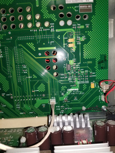

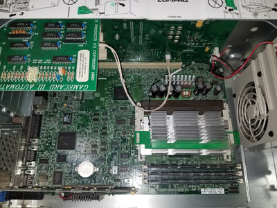

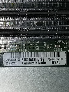

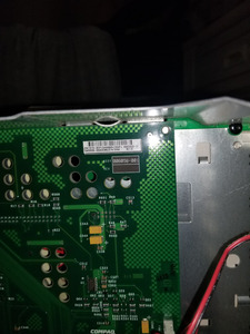

Reply 4 of 7, by DoomSlinger
I don't have the exact model number, but it's for a compaq deskpro en p550 minitower. Here are some pictures of the board and the part stickers.
Reply 5 of 7, by cyclone3d
From what I could find, there is no gameport / MIDI port on the Deskpro EN series.
