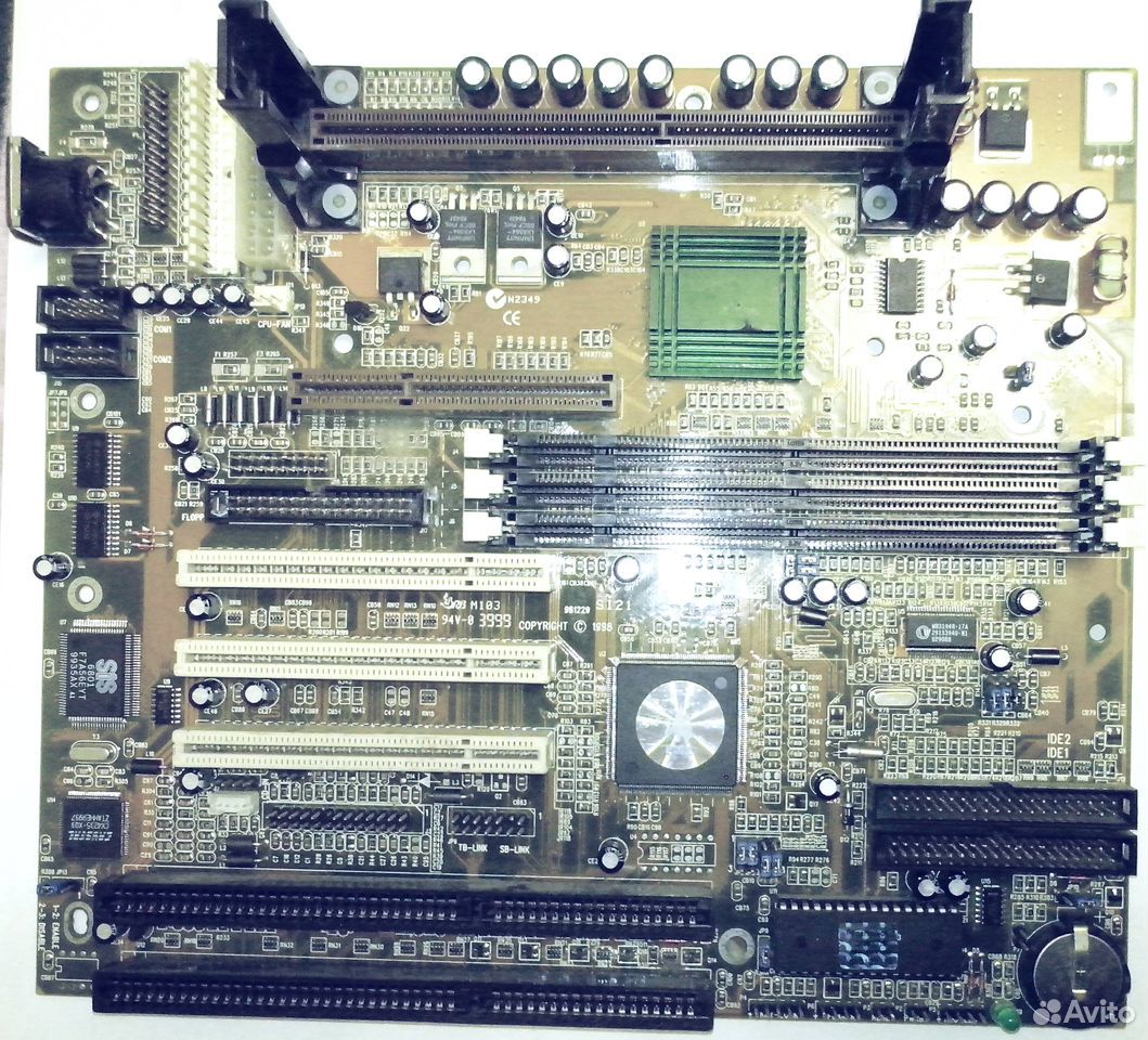

Hi in days the MB visible in the picture should arrive,
is a Baby-AT Slot1, for Celeron or Pentium II (or even III).
The chipset is SIS, that of the SB is a 5595, the NB instead is not visible because it is covered by the heatsink.
The BIOS is Award of 1998, has integrated audio (crystal chip).
There are two ISA and three PCI slots, one AGP 2X slot, and three DIMM slots.
The only thing visible from the photos is a silkscreened digit, it should be 981112, the second digit is unclear, in case it could be 961112 (or 951112).
I don't think it's a PCChips, but I could be wrong, I think it's something else quite similar.

From flicking through some options, it looks sort of like an Acorp layout, except for the BIOS chip in the wrong place and the wrong chipset. Ok, those are pretty major differences, but they do have the RAM between the AGP and PCI slots. e.g. http://www.win3x.org/uh19/motherboard/show/7974

seems to be a "PINE Technology SB1-A" board with SIS5600 chipset, I only found a single reference to it on some russian site: https://01.img.avito.st/image/1/GB6337axtPeBa … 9thZT18tPMLfr71
but that seems to be it.
Reply 6 of 64, by snufkin
Good pointer. I saw the photo showed SI21, so searched for that and found:
https://www.elhvb.com/mobokive/archive/Pine/S … si21/index.html
The .doc file is a manual, could be the right one.
[oh, wait, the photo imi posted had SI21 on the silkscreen, but I don't see that on PC@LIVE's photo]

This board definitely gives me a pc-chips vibe, and while the pine board is quite the match, just slight version difference, better vrm. I can't shake the feeling that this rolled out of one of the pcchips/ECS/... factories.

yeah the VRM is different and it lacks the marking that points to the "SI21" but that manual mentions the crystal audio so still seems to match.

In fact apart from some difference to the VRM, it looks just like the PINE of the link.
