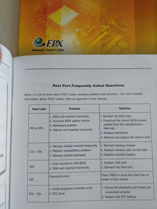

Hi,
I recently got a pc with the EPOX EP 8RDA+ and it turns on for a split second and turns of. No fans turn on, but I can hear my PSU click. Motherboard powers up when I take out the cpu, I also get the FF error code which i found out is either a dead mobo or cpu. Cpu inside is an athlon 2500+, barthon version. Dead motherboard or is there anything I can do?
Thanks!

I think PSU turning on then immediately off generally means an overload/short somewhere. If the PSU stays on when there's no CPU fitted then the problem might be with the CPU. Have you got any other's that you can try?

On my Epox 8KTA3+ Pro 'FF' on the integrated POST code card means everything is working and the system is ready to boot an OS.
If you take out the CPU you should only get bogus POST codes afaik. Maybe it's hard coded to display 'FF' when it only gets power?
Like snufkin said an immediately turning off / clicking PSU points to a short circuit, if it doesn't occur when taking out the CPU I'd also assume the CPU is bad. You should be able to find some Duron for next to nothing if you want to investigate further.

I read somewhere that FF is either all is good or everything is f*ed 😁 Will get a new cpu and test it, its a good board.

Reply 6 of 15, by wiretap
Post some clear pictures of the motherboard out of the case. Sometimes people can spot problem areas if there's something physically wrong with it.

First I'd suspect either capacitor and/or MOSFET shortage problem. Motherboards from that era have very often bloated or dried capacitors. While ago I replaced caps to my EP-8RDA3+.
Second, have you another CPU? Before trying with another CPU it's better measure using multimeter MOSFETS are not shorted. (done that - not a good idea)

sirotkaslo wrote on 2021-05-20, 12:36:
So it is Full Function as well as Fatal Fault. Nice!😄
