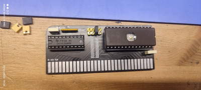

Here's the first rev of the first board soldered up. I'll setup a system to test it on and flash a BASIC ROM for testing. This i […]
Here's the first rev of the first board soldered up. I'll setup a system to test it on and flash a BASIC ROM for testing. This is really the first day in about a week I've been able to have 20 minutes free.. haha. I've been covering for my manager at work while he's on vacation and it's been some lovely 18hr work days. I hope to have Monday free to get this tested, but no guarantees. My wife starts back to college Monday, so I'll have to keep my 4-year old occupied as well. Busy times 🤣.
Thought I had some 20-pin sockets for the 688 chip, but apparently not. I'll have to order some.
that looks great thank you for sharing 😀

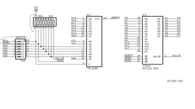

wiretap wrote on 2021-07-23, 16:37:
Designed a little boot ROM card this morning for running various ROMs in one of my XT boards that doesn't have additional ROM so […]
Designed a little boot ROM card this morning for running various ROMs in one of my XT boards that doesn't have additional ROM sockets. It has a jumper block for setting a wide variety of addresses as designated on the silkscreen. Should work on XT-->486 and other systems. I saw some other boards for sale that are similar, but they use more parts and are more expensive -- this should be a pretty cheap option if you want to build just a simple/small boot ROM card. I designed it for a 27C256 EPROM/OTP since those are pretty common and cheap.
KiCAD, gerbers, BOM attached. Not tested yet, but I have some boards on order.
EEPROM Version that is flashable, supporting 28C64B and 28C256. This one should be better if you need to configure and flash the chip from within the PC itself. (configurable ROMs) - just put the write enable jumper on:
^--the black box (S1) is a little DPDT switch, no 3D model available.
i am sure there is one 10k resistor missing from the circuit. This is the ROM enable.
Reply 38 of 39, by wiretap
Yea it is a possibility. I never got to test that board. I'll have to revisit the schematic design when I get back from out of town next month. A bodge could be soldered in place in the meanwhile.

Reply 39 of 39, by Phoboss1976
ignore my previous posts.
The small card works like a dream. Obviously I made a mistake when I used the incorrect XTIDE bin. If you look at the picture It only works where the jumper is set to. I tried it in 3 different machines. 2x386 and a 486 machine. The card works with 27c128 and 27c256. Whichever chip you use you will have to make the bin file to fit into the chip.
The bigger card? Hmm. It does not want to work yet. I have the correct chip. I have the correct bin. I just need to find the address where it wants to work.
Follow up.
Both type of cards are working.
Found the address. I use AT28c64. Only the first jumper needed.
