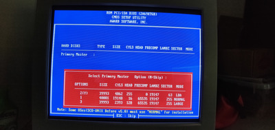

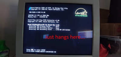

Reply 22 of 39, by astonsmith
Snookeroo wrote on 2021-07-25, 13:20:
When using Cable Select, the BIOS IDE auto-detect just hangs. When using Master or Slave it just skips over after a few seconds and reports "NONE".
Everyone is right about the 32GB limit, but I wanted to comment on this.
In your first photo you show a 40-wire IDE cable. To make cable select work, you need an 80-wire cable. If you can find one, it'll also enable higher speed DMA modes (= potentially faster performance).

Reply 36 of 39, by Snookeroo
Whenever I set my 40gb drive to "LARGE" mode in the BIOS the system just hangs right before it starts searching for a boot drive...
If I put it to "NORMAL" or "LBA" I'm able to boot to disk, but then fdisk will only make a partition of up to 8gb.
Gah! I've been at this for weeks! What should I do?!
Thanks again for all the help and support, Vogons.
Reply 37 of 39, by Chkcpu
Hi Snookeroo,
In the Award BIOS drive Setup, the "NORMAL" mode doesn't do any HDD parameter translation and will therefore always limit you to 8GB.
The "LARGE" mode is for drives that don't support LBA addressing, so it is seldom used.
The "LBA" mode is your prefered choice, and supports drives up to 128GB in this patched BIOS.
I don't know about Dr DOS, but MSDOS 5/6 is limited to 8GB drives and so is its version of Fdisk.
Just use Fdisk from Win98SE/Me to make larger partitions.

Reply 39 of 39, by Snookeroo
WOOHOO, VICTORY UPDATE
I got it! I am now finally inside a 40gb install of Windows 98SE!
It turns out that the automatic drive detection in the BIOS was setting the size of the drive to 2gb after you hit accept. I found this by going into a different screen of the BIOS and manually editing the drive size myself to 39993mb. Once I did this, and ran the drive in LBA mode, I was able to format all 40gb and install Windows! Excellent!
