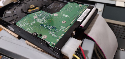

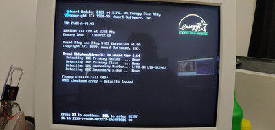

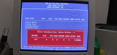

Hey gang, I was having a blast doing my first retro Windows 98 build until I hit this snag. Would greatly appreciate any help/advice you can offer.
No matter what I do, my BIOS will not detect my 40gb HDD at all! Here are some details:
Mobo: Tekram P6Bx-An
CPU: Intel Pentium 3 550E mhz
BIOS: Award Modular BIOS v4.51pg
HDD: Western Digital Caviar WD400BB 40GB (see pics attached hdd and hdd2)
The HDD LED comes on when the BIOS is searching on the appropriate connection, so I know the HDD is receiving power. I have attached some pictures (bios1, bios2) showing what I get during the BIOS IDE auto-detect.
Things I have tried:
- Ruled out that there's any problem with the IDE cables, I have two of them and both the Master and Slave positions work fine when detecting my CD-ROM drive.
- Tested each of the jumper settings. When using Cable Select, the BIOS IDE auto-detect just hangs. When using Master or Slave it just skips over after a few seconds and reports "NONE".
- Ruled out any problems with the molex power connector. The same connector works fine when powering my CD-ROM drive.
Could it be possible that my BIOS is limited to only detect 32gb drives? If this is the case, how do I check for that?
Thank you in advance for the assistance. I really need a saviour here! I bought the HDD off a trusted seller on eBay who reported it as tested and working.

Reply 1 of 39, by AmiSapphire
That board's BIOS has a 32GB HDD limit (bug). There is a 128GB HDD patched BIOS on http://wims.rainbow-software.org, but I would back up your original BIOS in case something goes wrong.
http://wims.rainbow-software.org/ajz/Tekram%2 … BX-A%28n%29.zip
Edit: That BIOS is out of date (latest is v1.08), but even the latest version has the 32GB limit.

Reply 2 of 39, by dank0
Or get PCI IDE controller (Promise etc.)

Reply 4 of 39, by dank0
Also i forgot to mention almost every IDE HDD has Jumper setting to limit 32GB of use for BIOS - https://www.reclaime.com/library/hard-disk-ca … y-clipping.aspx
I have to do it for one of my drives on old Asus board with seagate drive

Reply 6 of 39, by dank0
Here is WD manual - http://www.supremelaw.org/systems/wd/western. … er.settings.pdf - your settings to recognize the HDD is image - Figure 6. Alternate Jumper Settings for Hard Drives
your drive is only 40GB big so you will loose 8GB
