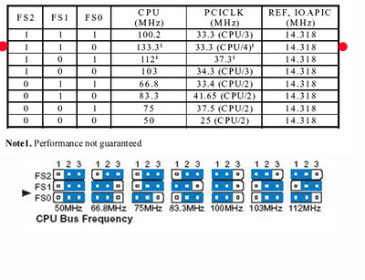

There are early 440BX motherboards that can go as low as 50MHz but it depends on the frequency generator that is installed. My ASUS P2B-S rev. 1.03 has an ICS 9150-08 that covers 50MHz through 112MHz.
I don't think that multipliers can be set to lower than 2x but I may be mistaken.

Reply 4 of 34, by The Serpent Rider
Maybe even 1x50mhz is possible?
Minimal multiplier for P6 is 2x.
It seems likely that Pentium 2 <333 MHz made before week 34 1998 are unlocked.
Deschutes also had 300 Mhz model.

Maybe some exotic test sample once did 1.5x multiplier in an Abit lab. But normal Pentium IIs cannot do that, 2x is the lowest.
