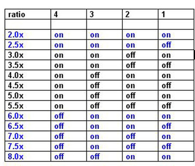

Assuming that most if not all PLL-based frequency multipliers in that generation of motherboards are based on the same principle the below settings of this extended version of your multiplier could work:
49.76 KiB
682 views

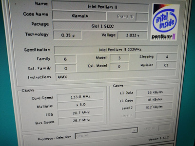

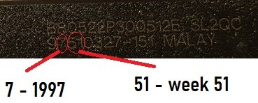

It's working! I did use x5 multiplier and it realy is x133 with L2 enabled.
Today I will post benchmark with different clocks.

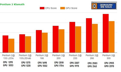

Reply 14 of 20, by dragonkn
I did tests and benchmarks @133 mhz to @300 mhz (i tried oc to 366 but it's not working).
Extended version of CLKMUL setup from PARKE is working great.
I didn't saw any problems and instability, if any problem will occur i will post in this thread.
Thanks for help! 😀
