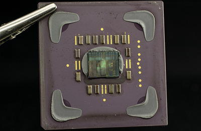

Have an idea,
Need help confirming,
I’m wondering if it may be possible to enable the 256k cache on k6 2+ 570 cpus by de-lidding them and making resistor/pad mods
It’s not so crazy considering the socket athalon/durnon cpus from amd had mods like this right after the k6 line
I need help tracking down pics of a 2+ and 3+ without a lid on them. So we can visually compare.

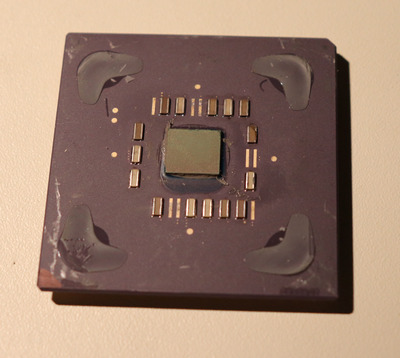

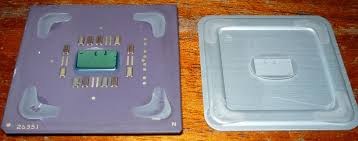

Reply 2 of 550, by Sphere478
Found these images, no indication of what the chips are but it’s clear that heat is needed to remove the chip without destroying it

Reply 6 of 550, by Repo Man11
This is a decapped K6-2E+ 570.
"A lot of times when you first start out on a project you think, This is never going to be finished. But then it is, and you think, Wow, it wasn't even worth it." - Jack Handey
Reply 7 of 550, by Sphere478
Repo Man11 wrote on 2021-12-10, 03:29:
Sweet! Can we get a high res of the middle all cleaned up showing all the tiny gold pads?
Eventually hopefully someone shows up with a 2+ and a 3+ and can do some continuity measurements I’m wondering if amd didn’t pop a fuse in the package in order to kill the 128k of cache. Maybe it can be re bridged
Sphere's PCB projects.
