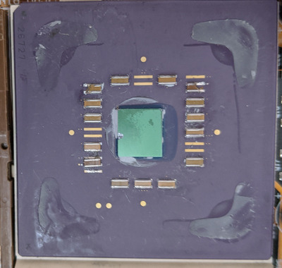

Reply 557 of 574, by asdf53
And this is how my CPU looked after taking the lid off.
I found it very difficult to remove, took me 15 minutes to cut through the corners, then another ten to pop off the lid. It wouldn't come off and I felt a lot of resistance, so I kept cutting into the corners, accidentally cut two of the resistors in half. I soon realized that the die is also glued to the heatspreader, that is why it's so difficult to pop off.
When I finally managed to remove it, it took a chunk of the die with it (visible on the left side). I was 99% sure that I had killed the CPU, but it still works!
To glue the heatspreader back on, I made a thick paste of soldering rosin and isopropyl alcohol, painted it on the remaining glue pads and pressed it together.
