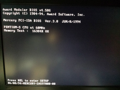

I recently got a socket 4 board - GA-586IS rev.3 - which seems to be in very good condition. The BENCHMARK clock module holds the time so there also seems to be some battery charge left.
BIOS recognizes my 512MB CF card at the IO-card just fine. I tested it with every P60 I have (5-6) and they all boot up fine up to the first boot screen:
1.57 MiB
1115 views
But then...nothing. No error, no complaint about anything. It just stops there.
I already tried without the IO card but that makes no difference.
What am I missing? What could be the reason for that?
Thanks for any clue!

It might have a problem detecing hard drive or booting from it (if preconfigured in setup).
I'd make sure to put the most conservative settings (incl. disabling L2 cache). Remove any other cards if installed. Double check disk setting or, even better, remove hard disk configuration altogether and boot from floppy. Then it should go one step further. It might be easier to boot from a floppy drive.

Wrong settings in Bios might be, a battery going weak but still holding time prevented a 486 board from booting at home.
Might be the same here.
My next step would be to use a post card to see what happens after the initial screen.

Got it working!
I wasn't aware of that the order of ISA cards is relevant.
After loading BIOS defaults it could boot from floppy, however, booting from any configured harddisk did not work.
I then used a PCI graphics card and it did boot from harddisk. Ha!
Switched back to ISA graphics card and tried some other slot configurations and finally found one that worked (may not be the only one).
I never had more then one ISA card in a system - the sound card - so these "effects" were unknown to me.
Now I know that the board is functional which was all I had in mind.
Problem solved.
Thanks to everyone!

Order of ISA slots shouldn't matter. If it does, probably one or more slots may have dirty contacts. Just removing and inserting cards may have made the difference, not the order as such.
Order of PCI cards can make a lot of difference. PCI had 4 interrupt lines and allocation of lines to slots, and interrupts to lines, may cause issues. On older boards like this, I'd expect it to be possible to manually allocate IRQ to interrupt, and possibly interrupt to slots. Make sure the PCI stuff doesn't conflict with whatever you've set on the (non-PnP) ISA cards.
