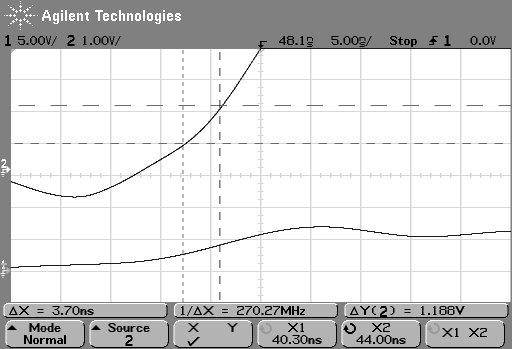

Reply 20 of 45, by crazytiti
I check the clock on the socket with and without cpu, and it's out of spec 😒 (~4.5ns and ~4ns)
The 74act08 get +5Vcc and 0.012Vss so power is OK
I have doubt about the reset : sometimes it goes straight 0V even if the clock is not OK. And i try to push the reset button, it does nothing to the state of the socket reset pin.
59476 59477

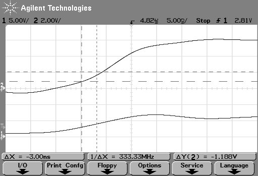

Reply 21 of 45, by crazytiti
After un-plugin/plugin all thing one more time the SC425 came back to life bringing me a nice 33Mhz sine on socket.
Even meeting the 3ns rise time spec !
But still no beeps (my speaker is a true speaker so i can't plug it backward it will work anyway), no boot no VGA output.
At one moment without any chips (no cpu, no ram, no bios, no jetkey) i have seen "tops" on the bios addresses.
But when i plug back the cpu they were gone.
59530

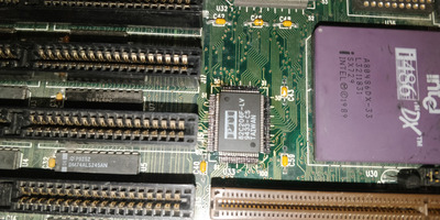

Reply 33 of 45, by Deksor
Hello, I'm the new owner of the board 😁
So I replaced the 82c206
1.79 MiB
228 views
Unfortunately the symptoms remain exactly the same 🙁.
I have a post card with more LEDs and one reports the reset signal status. I noticed that the reset signal does never fire. Not at the startup, not when I use the reset button. Just never.
I also saw that the reset button goes straight into the chipset. This makes me wonder if the chipset itself isn't toast 🙁
