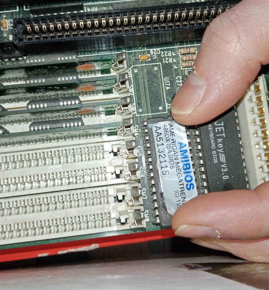

Edit : here is the bios sticker
58977
Reply 4 of 46, by crazytiti

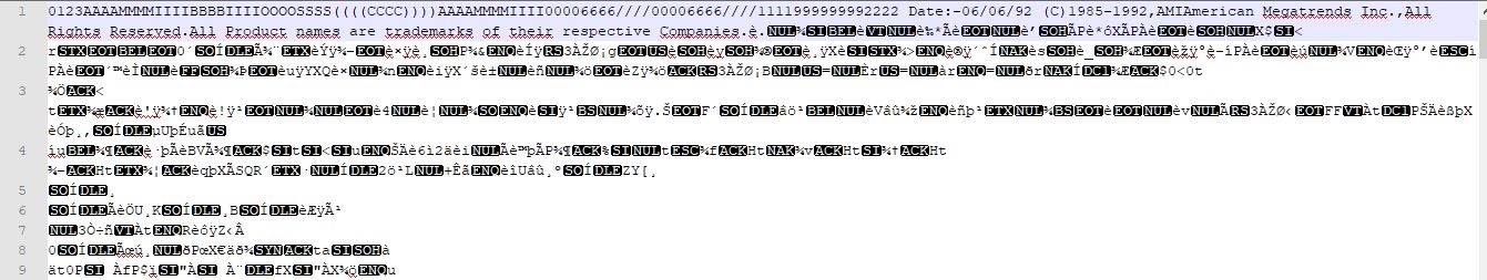

I check the bios, i think it's me some time ago that unglue the sticker because under their is an aluminum tape to protect the eeprom !
I have read the bios and it's seems OK, i've uploaded it, if someone with AMI bios knowledge could check it :
http://crazytiti.free.fr/divers/AMIBIOS%20486 … 115%20c1992.rom
I even find the AMI bios ID in the bios :
40-1200-001805-00101111-060692-USA-9204

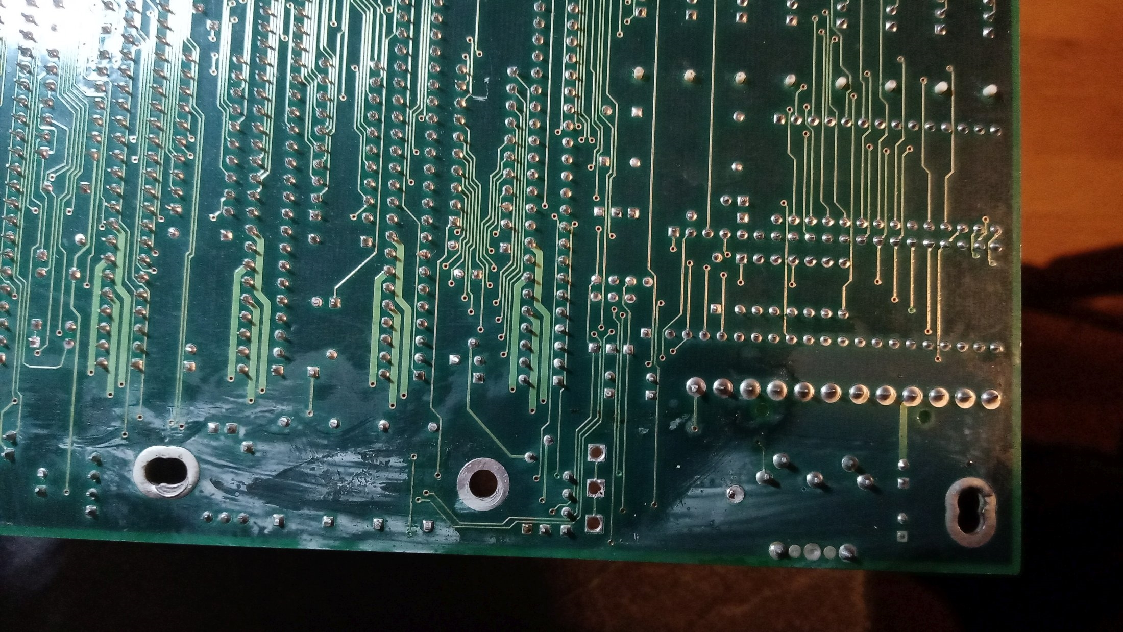

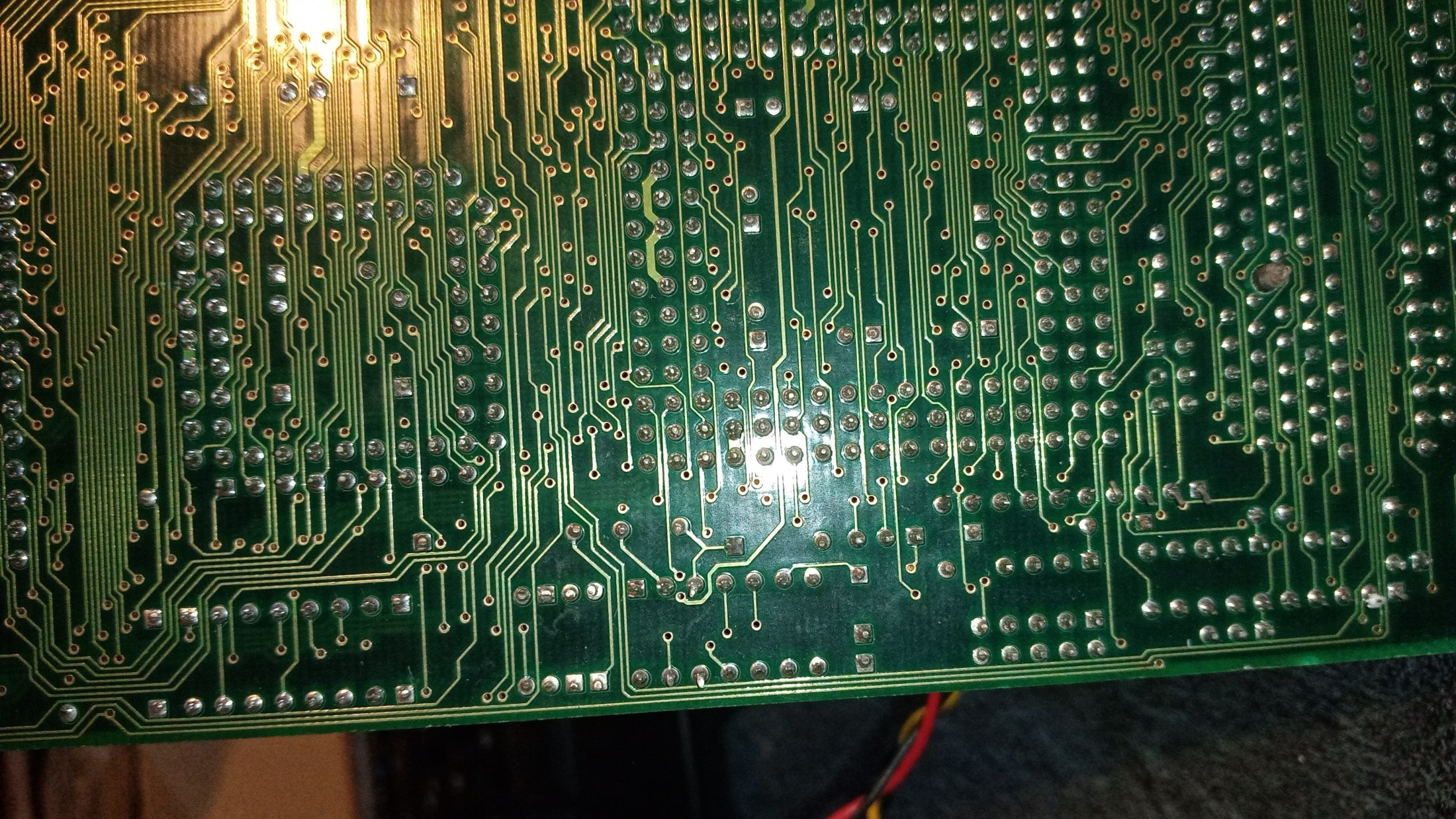

Reply 6 of 46, by crazytiti

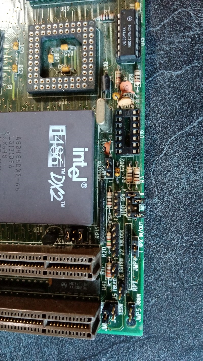

I ran some tests tonight :
Put an 486 dx33
- Bios voltage OK, but address and data lines are stuck
- Battery voltage was originally ~2V, 4V when powered, 3.8 at rest.
- i measure "clock" pin on 386 socket (the one next to the "key pin) and got continuous 0V or 5V or 1.9V randomly each time i powered on the system.
- the Power Led and Turbo Led are OFF
- Cpu is a little warm, as the GPU (can i call it like that ?) so power is going somewhere at least !
- i try without any ram and without any cache : nothing change
- try with a 486 dx2-66 : nothing new
- i un-soldered the battery : trace are OK (see pictures), but nothing better
So i think clock management isn't working, any idea ? there's a little 2 pin ~14.xxxMhz quartz next to the speed jumpers and another small cylindrical one between two isa slots.
59229
59230
Reply 7 of 46, by snufkin

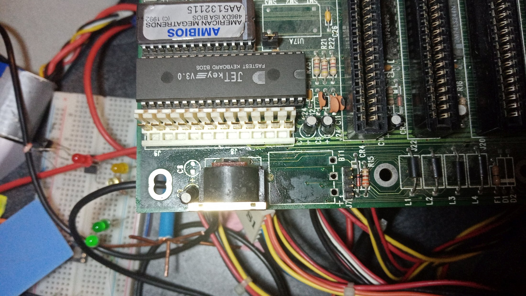

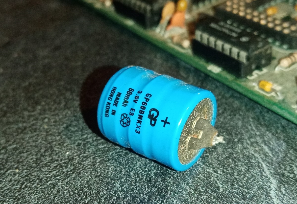

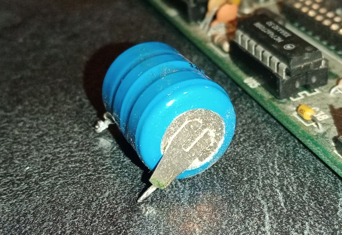

The one near the CPU sockets will be the main clock, the small cylinder will be a 32.768kHz for the RTC. Have you got a photo showing near the 14.318 crystal? That is probably buffered through a clock buffer nearby, so would be a good place to look for an active clock.
Looks like the battery has leaked, there's some gunky looking stuff around the keyboard connector. Probably a good idea to give the board a wash in that area. You might also want to remove the keyboard, power and J7 connectors to clean underneath them.

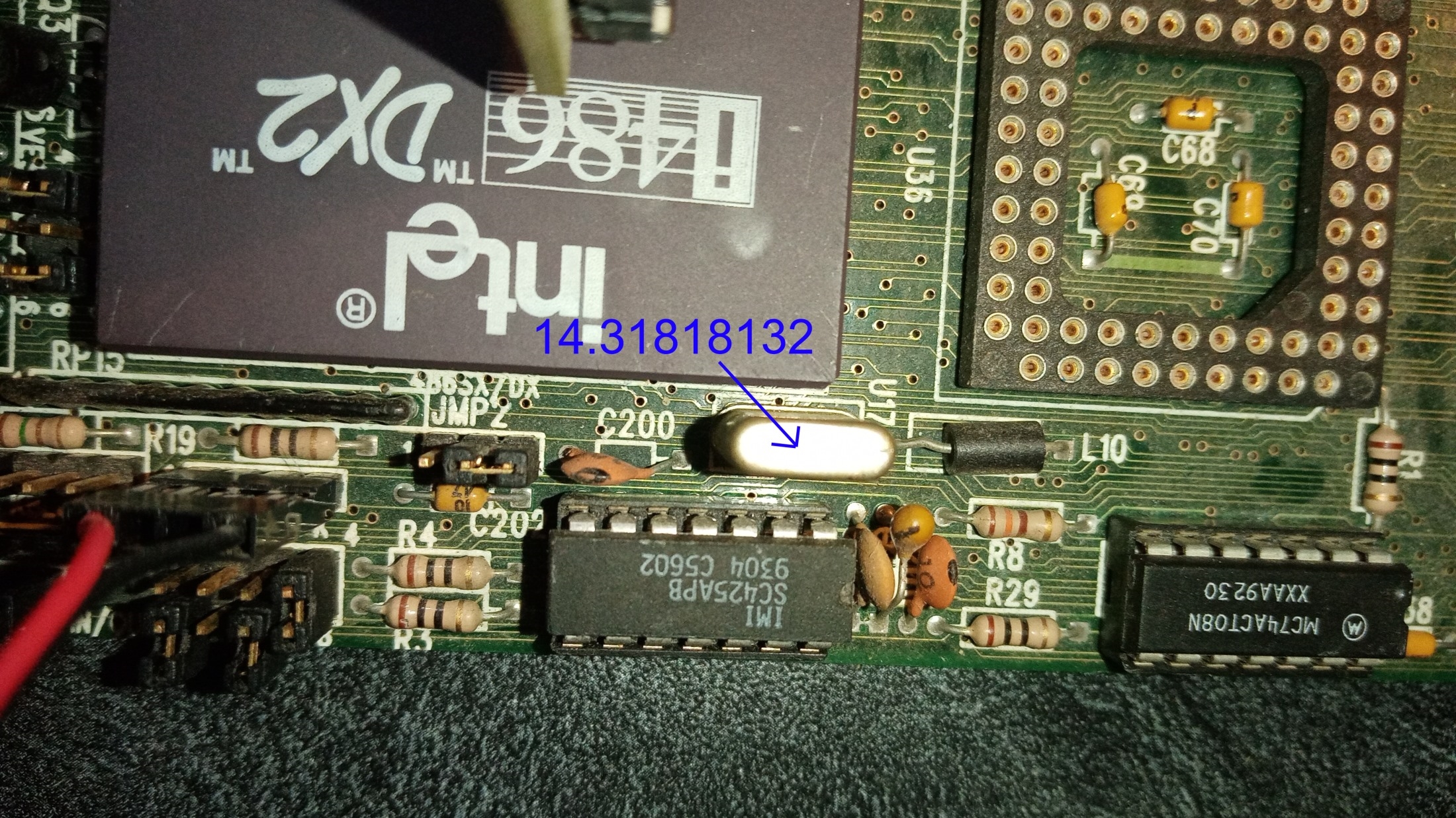

Reply 8 of 46, by crazytiti
Ok i already do a little wash with 90°alcohol and a toothbrush, but you're right it need more.
Although i thought the battery to be relatively clean.
Here are two picture (front and back) of the surrounding of the quartz, is the SC425APB relevant ?
I didn't find the correct datasheet 😒
Edit : https://datasheet.datasheetarchive.com/origin … AIH00054001.pdf
59249 59250
59247 59248
Reply 9 of 46, by snufkin
[edit: ah, I missed that you found the actual data sheet, nice. So check pins 8,11 & 13 for clock signals]
Found an overview of the SC4xx family of clock gen chips: https://www.datasheetarchive.com/pdf/download … pe=O&term=SC425
That has lots of useful information for the SC425, but no actual pinout. But from that we know there are 3 clock outputs: Reference (@14.318MHz), MCLK1 (half MCLK2) and MCLK2 (selected by S0-3, with S3 looking like the turbo input).
Wild stab, but looking at this: https://www.ultimateretro.net/motherboard/manual/31843.pdf my guess is that JMP9 1-5 connects the clock to the 386 socket. 2-6, 3-7 and 4-8 somehow control S0 and S1, but I can't see how. JMP14 might have something to do with wait states on the VLB slots when running at 50MHz.
So, if you set the board for a 386/25MHz (JMP9 1&5,2&6) then you should find 3 pins on the SC425 with clocks, one at 14.318MHz, one at 24MHz (they cheat you out of 1MHz) and one at 12MHz, and you should find a clock on the 386 socket. Remove 1&5 and the clock to the 386 socket might disappear. Move the jumper to 4&8 (as I think it is now) and you should find the 24 and 12 clocks change to 32 and 16.
[Oh, and the white crystalline stuff on the battery is a sign that it's leaked, along with the green corrosion. And that stuff will sit on the board slowly eating at anything metal. Vinegar is apparently a good way to shift it (acid against the alkali battery fluid), then water to wash the vinegar away, then IPA to flush out the water and dry the board off.]

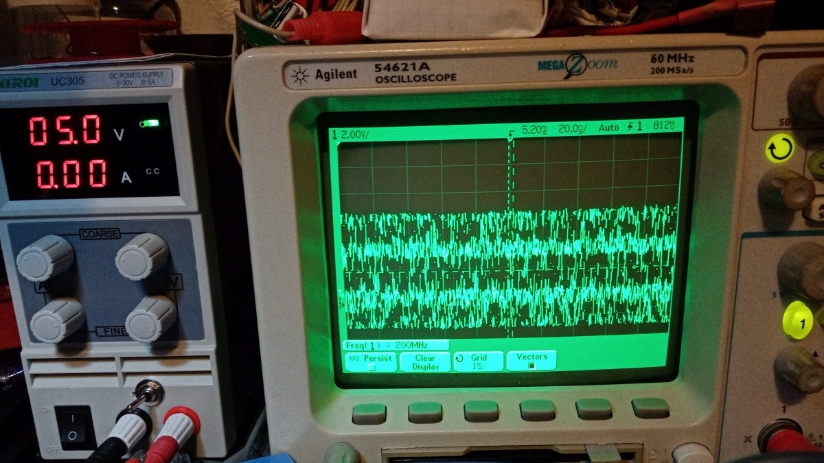

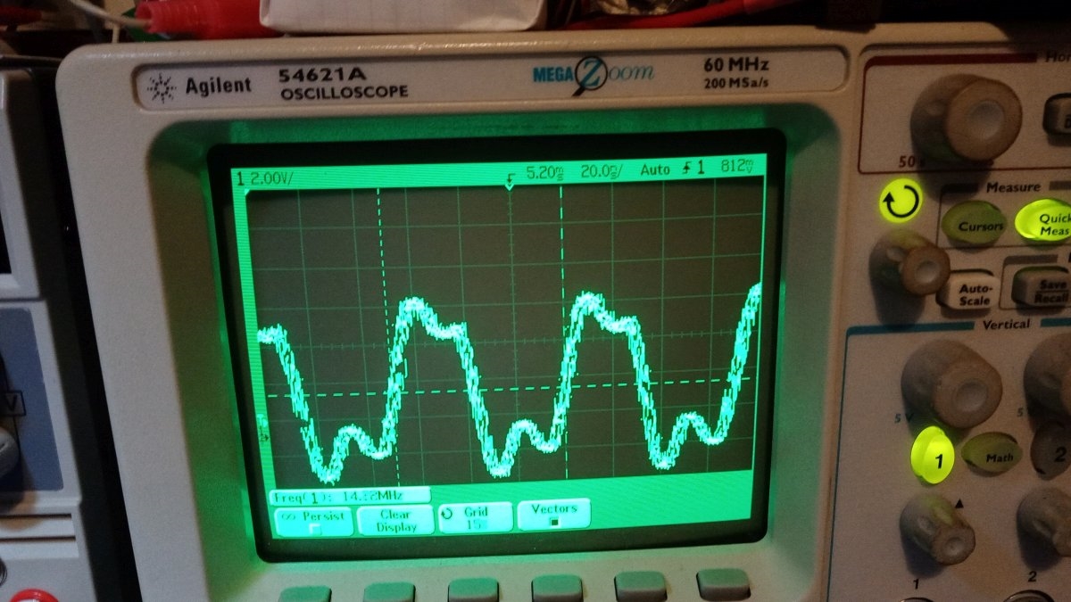

Ok so i have tested a few thing and i'm afraid that this motherboard is deadly dead 😒
After some cleaning i can tell that the trace under the keyboard connector and J7 are ok
So i have run a few test :
The SC425APB does not generate a valid clock : on the Ref pin signal is OK but MCLK1 and 2 are garbage.
Then this garbage goes to an AND gate (74ACT08) and the output of the and go to the two socket.

Reply 11 of 46, by snufkin
Well, that looks like a possible cause of the board not working. Very likely the board will need the reference clock, and probably both MCLK1&2 (chipset may need a half clock, maybe?). You can see traces and a via going from pins 11 (MCLK1) and 13 (REF), so very likely they are used somewhere.
[edit: oh, and I think MCLK2, pin 8) is the main CPU clock. MCLK1, pin 11, is MCLK2/2]

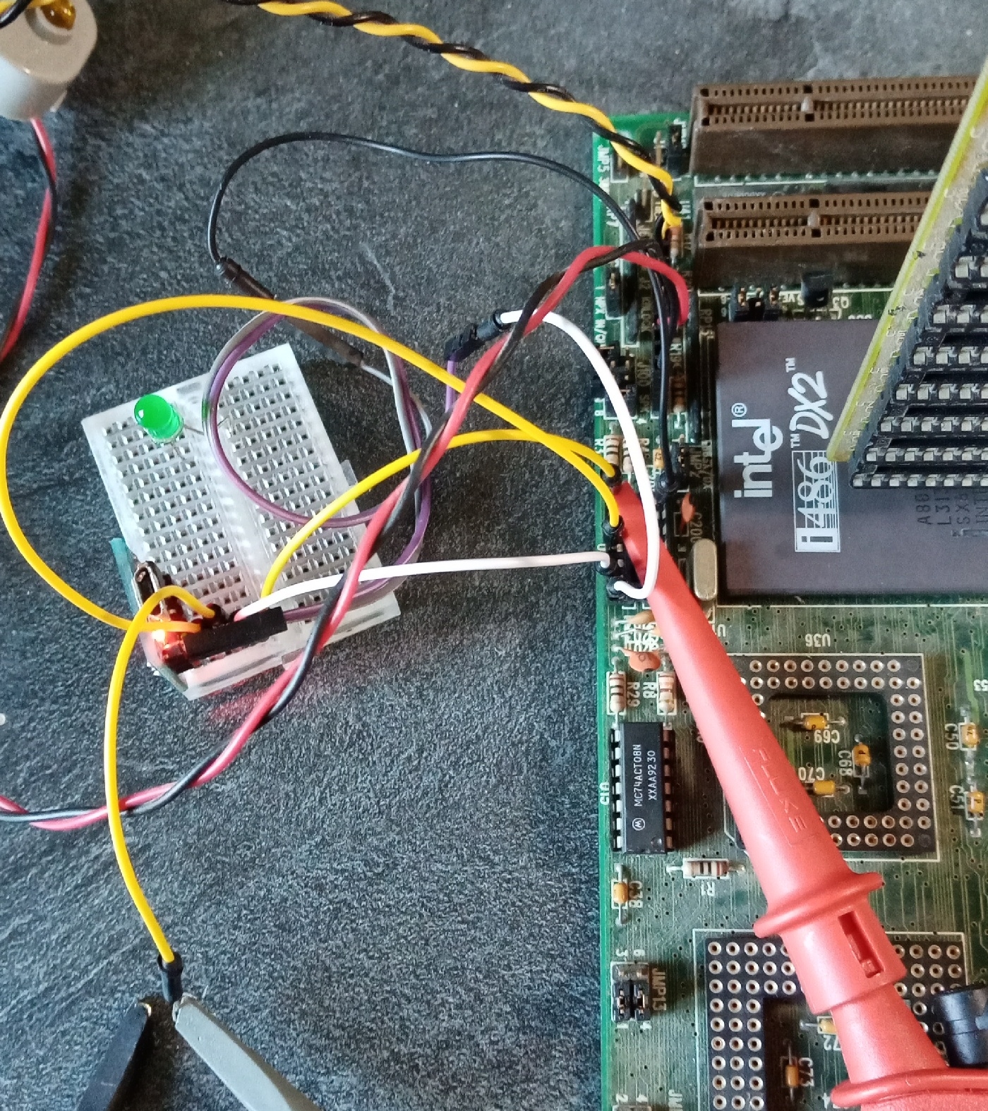

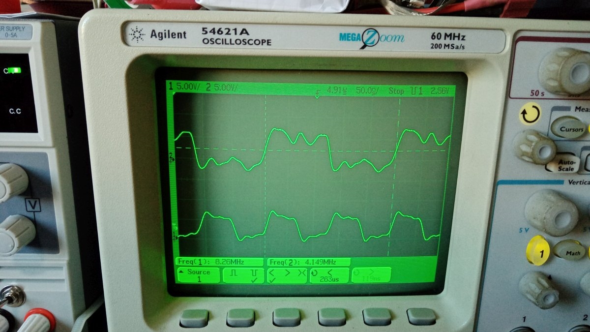

Reply 14 of 46, by crazytiti
Thanks for the explanations 😀

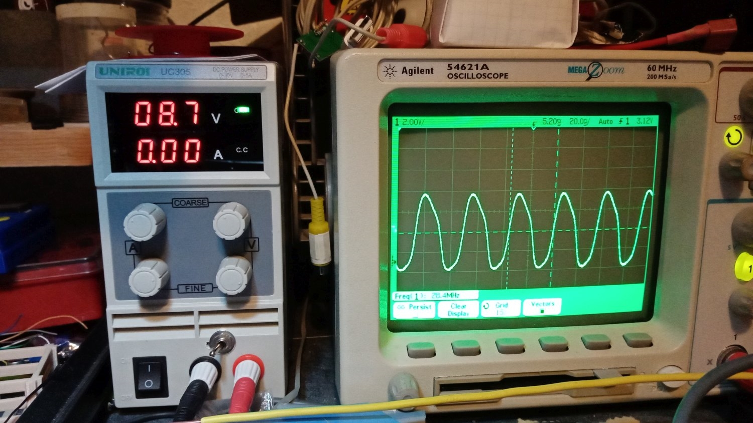

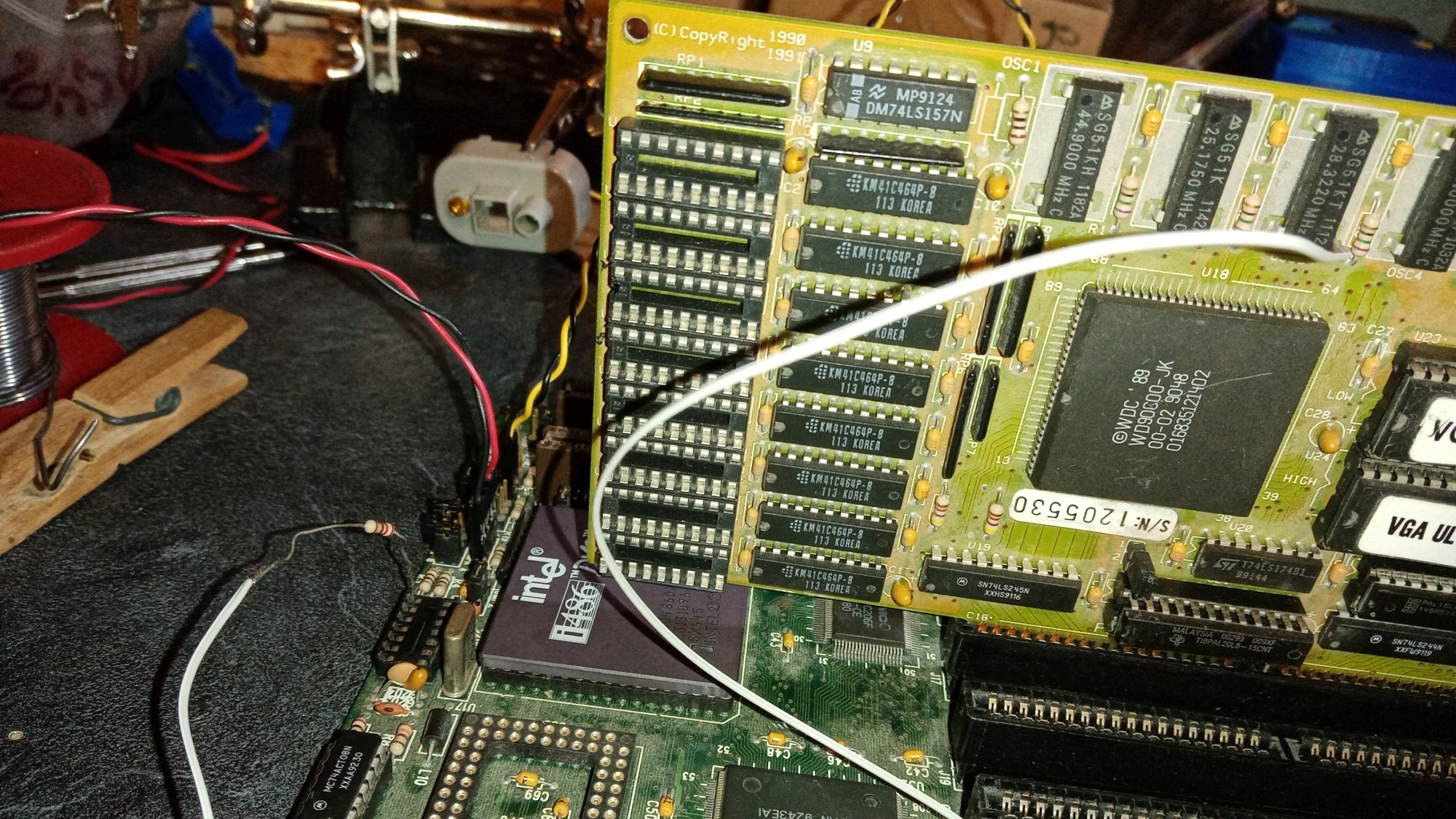

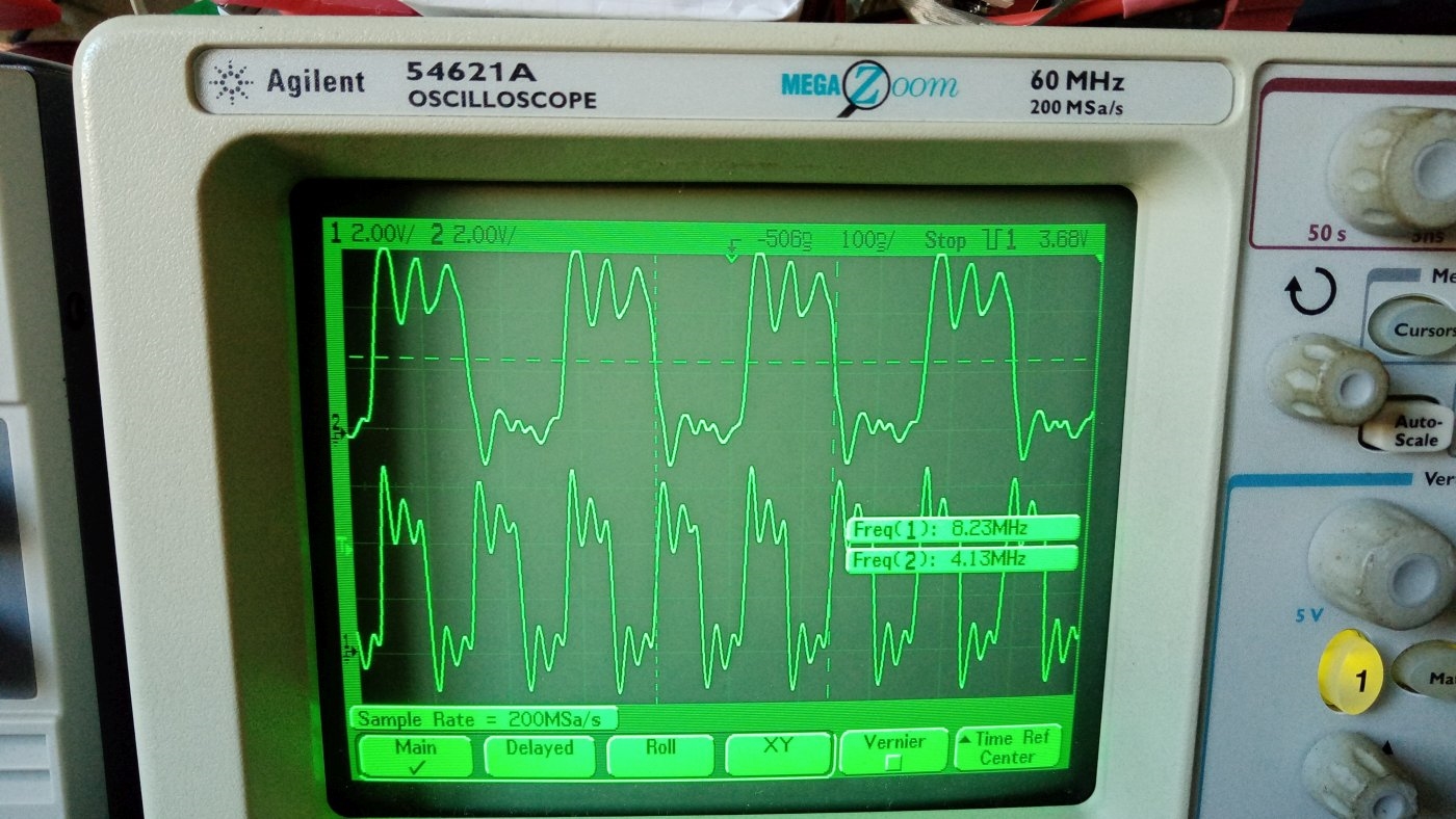

So i get an ATtiny85 which has ability to toggle pin in one cycle, i make two signals 8 and 4Mhz in phase
59345
i plug it in MCLK2, 1 and REF (i use the 8mhz to put in REF)
59347
The signals have "good" waveform when plugged, so impedance and current capability of ATtiny where good enough.
59348
But, nothing change, no beep, no power led and nothing at screen
I found a ~230 ohms resistor (R20) from one pin of Power led to ground. At least now i know in which way i have to plugged it...
59349

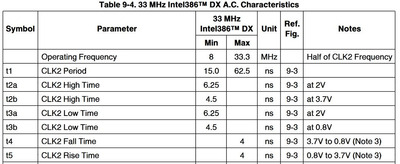

I just looked up the datasheet for the i386DX-33, and that has a minimum clock of 8MHz (and a maximum of, oddly enough, 33.3MHz). So depending on the CPU you might be on the low side.
Maybe it's worth taking out any cpu and checking what the clock and reset signals look like on the socket. As I understand it, the chipset will hold the CPU in reset until various conditions are met (like stable clocks). Once reset is released to Ground then the CPU will fetch its first instruction. So if you can see a clock, and the reset signal goes low, then with the CPU fitted you should be able to see activity on the BIOS chip address lines.
Unfortunately I haven't found a datasheet for the main chipset, so I don't know how it will handle the reset.
Actually, looking at the 386 datasheet on the clock, it's fairly strict:
64.26 KiB
1803 views
There's a maximum rise time from 0.8 to 3.7V of 4ns, and the same for the fall time. Just eyeballing the scope trace it looks like maybe the 8MHz clock isn't rising and falling quite fast enough, so maybe there's not quite enough drive strength, or too much line capacitance?

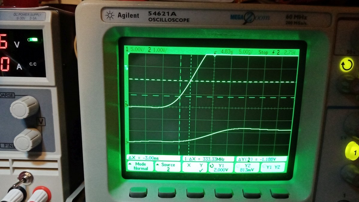

Reply 16 of 46, by crazytiti
i study the 486 dx2-66 (the last that i put in the socket) and it says 8 - 66mhz and 3ns for rise/fall clock.
I will check the reset pin on the socket.
Oh, i surely miss-plug the led because i assume that was the 2 first pin on J2, but it's written nowhere in the doc.
Reply 17 of 46, by crazytiti
Yeahhh ! finally some progress !!!
The power LED is ON !
You we're right the resistor was on the +5Vcc and the pin next to it was nothing.
I also check the reset pin on the socket.
It goes to 5Vcc until my arduino generate clocks (digispark take 3-5s to start) so it's doing its job !
Next here is a zooming of the 8mhz clock : it's 3ns from 0.8 to 2V exactly matching the min spec !

Reply 18 of 46, by snufkin
Woohoo! Is it wrong to be glad about being able to get an LED to light up?
Even better about the reset going to ground, so the CPU should come out of reset and start reading instructions from the CMOS. Might be worth going back to check the BIOS address and data lines for any activity now that there are some clocks around.
Just to check, channel 2 before was the 4MHz signal, is that the same signal you're using to check the rise time? Also, on the earlier trace it looked like a bit of ringing caused the low period to drift up above 0.8V, before it started to rise strongly later. And was that measuring from the CPU socket? I just want to make sure the clock is actually getting there since you mentioned it goes through an AND gate.
Reply 19 of 46, by crazytiti
I check the timing on the 8 mhz signal at the output of the arduino (i plug / unpluged the stuff multiple times so i may have invert the probes), i will check on the socket.
I've already check A0 and A1 on the bios and they're stuck at 4.08V (even the vcc of bios is ~5) it seems odd.
How is the bios connected to the cpu ?
