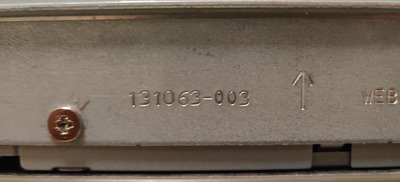

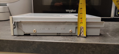

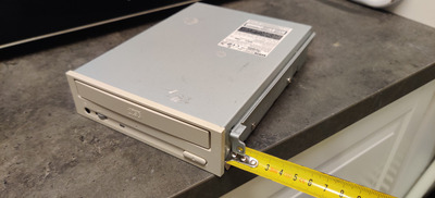

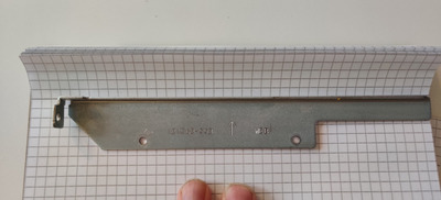

I have a Compaq Prolinea 486/33 and I wish to add a CDROM drive but I need the special Compaq drive rails.
I was wondering if anybody has the measurements & dimensions for these rails and can share as I want to attempt to fabricate them myself from spare metal. Maybe with some photos if you happen to have them.

I took some pictures with a (metric) measuring tape. Also with a paper that has 5x5 mm squares. Hope thats enough. I did not measure the thickness of the steel but I guess it is between 15-20 mm the kind you get in cases.
