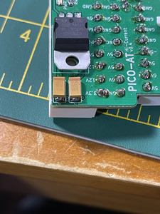

Reply 135 of 156, by ajacocks
I have had the same polarity issue on mine. After running for a while, the c1 capacitor smokes, which is odd, since I verified that the pads next to the edge of the PCB are grounded.
I’m using PCB v0.4, as previously mentioned. Sorry it took me so long to actually test! The adapters work just fine otherwise.

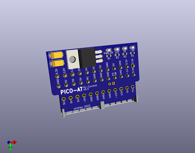

Interestingly, the 3d render that you included with the archive, @wiretap, shows the SMD caps in reverse polarity from how I installed them. That doesn’t make sense, though, as the stripe on SMD tantalums indicates positive:

And how I soldered them:

Don't know why it doesn't make sense. If you install a capacitor backwards, it will smoke. They are on a negative voltage rail. Ground is more positive than a negative value. 😉

So is the c1 c2 placment reversal not causing a issue here? It’s actually the people building them putting them in backwards only?
I mean of course it makes sense, another blowing up capacitor just made me go wtf is happening. Needed a sanity check.
If I recall when looking up the specs of these caps -5v and -12v was all within the ratings of BOTH caps. So being in the wrong spots shouldn’t have caused a failure. So what wiretap says about them being backwards makes sense.
I can upload a corrected latest version for C1 C2 positions in about a week if I am reminded.

Sounds like it. I can see that happening when orienting the capacitor based on its markings and ground, because usually ground is the most negative end, but not here (-5v). I've done that mistake myself, on another project.
