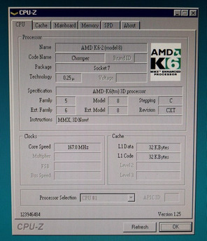

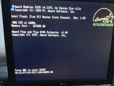

Reply 7 of 7, by asdf53
I finally tried it, it works!
Inspired by this thread: Running a K6-2 at single voltage? - running a K6-2 at 3.3V on an unsupported single voltage board.
I set the board to 2.8V, the lowest possible voltage, intended for Pentium MMX processors. This is how the board identified the CPU:
176.04 KiB
133 views
The actual clock speed is 66 x 2.5 = 166 MHz, but the BIOS would always detect it as 66 MHz. The CPU heatsink didn't get very warm. But the voltage regulator runs very hot at 2.8V, I almost burned my finger, so I did not dare to run the CPU at the default speed of 400 MHz. Newer Socket 7 boards usually have multiple voltage regulators to split the load and keep the temperature reasonable.
