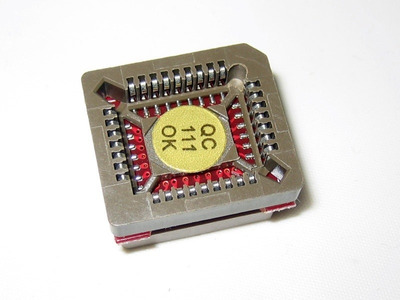

From Google images the board Winbond W49V002AP bios has pins on 4 sides (32 Pin PLCC) you need a 32 pin PLCC to DIP 32 adapter, very common adapter for TL866.
My XGecu TL866 II Plus (xgecupro ebay seller) came with 13 adapters which included two different 32 PLCC to DIP adapters.

You cannot connect the adapter to a soldered PLCC. They do make "clips" with short cable but have never seen one for the 4 sided PLCC, only for two sided smaller SOIC and TSOP types (and they are rare and very expensive !) .
Reply 4 of 23, by Sphere478
Unsolder the chip with hot air, order a socket, and an adapter for programmer. Then program and install in new socket

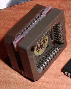

Reply 13 of 23, by Horun
Yes it is possible to use the ECS Top Hat adapter if you can find one, you still need to program another flash chip with your proper BIOS and have it in the Top Hat.
So if you could find one you would need another Winbond W49V002AP that you program with your TL866. One thing I always wondered was how they work since Dual bios boards have a jumper to change between.
The Top Hat must be able to disable the on board BIOS or else it would run in parallel which surely would cause some major issues with diff codes being simultaneously delivered to the data bus 😀

Reply 16 of 23, by Horun
Yes I looked at that too, one of the docs from ECS shows exact same BIOS chip but could not figure out how the onboard would be disabled. Friends dual BIOS board has a jumper for A or B but the Top Hat has none.....
https://cdn.staticneo.com/neo_image/143929/ar … eme/tophat2.jpg (from https://www.neoseeker.com/Articles/Hardware/R … 1extreme/2.html )
and https://www.coreboot.org/Developer_Manual/Tools#BIOS_Savior says about Top Hat:
"The RST# pin is wired to OE# on the spare chip" works some how if they are correct,
need to read the datasheet with a clearer mind because that tells me to how enable the Spare but does not explain the shut off the on-board unless I am missing something 😀
Added: " By means of some 'obscure' cicuitry" and " Sadly, this simple technique does not seem to work with other boards right away. " Sigh ! 🤣

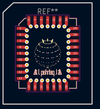

Reply 18 of 23, by Sphere478
Okay,
67.05 KiB
1852 views
14.72 KiB
1852 views
15.67 KiB
1852 views
The images that I can find seem to show all of the traces going to the lower layer.
what happens there, we are left to ponder and research.
In the meantime, I finished the device. only thing left to do is to figure out the wire trick and incorporate it.
